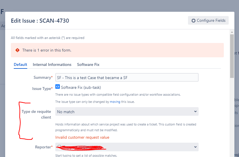

We have a Customer Service project in Jira Service Management project that is used by our customers to open requests. We want to be able to use sub-tasks in this project.
I am able to create the sub-task without any issues, but when I try to edit some of its fields (from the Edit button), I am unable to do it, because the field Customer Request Type has no match.
I tried to see if I could change the parameters in the Field Configuration Scheme, but it is not allowed for this field.
Any ideas on how I can succesfully edit a sub-task in a Customer Service project?

I'd messed around with this a bit more yesterday afternoon and found a fix
  1. Create a new sub-task screen (without adding the customer request type to the screen)
  2. Create a new sub-task screen schema and associate that with the new screen
  3. Configure the Configure Issue Type Screen Scheme for sub-tasks, by adding the new screen schema to the sub-task issue type.
Sub-tasks are now editable without an error.
Hope this helps!
