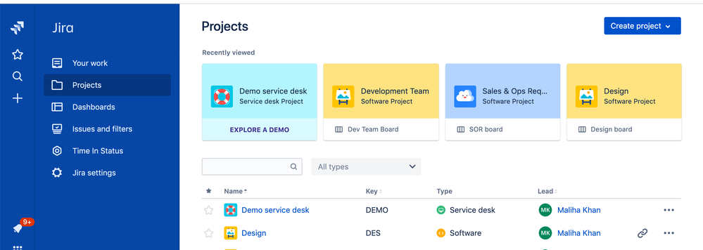

  • I'm using the demo project that comes with the SD set up.

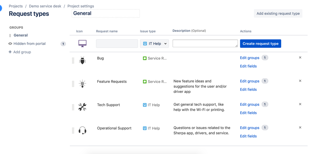

The odd thing though is that when I go into request types now, the old issue type linking doesn't show anymore. It has linked the request to one of the remaining two issue types. So maybe it just didn't refresh at that time? Although I did try on a new browser window multiple times.
So the issue I was facing seems to have been resolved for now. But could have a deep-rooted cause that you may want to investigate.
