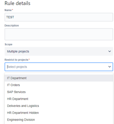

I did set it up as multi project rule, yes. The JSW project name is RD Engineering and it does not appear in the drop-down menu.

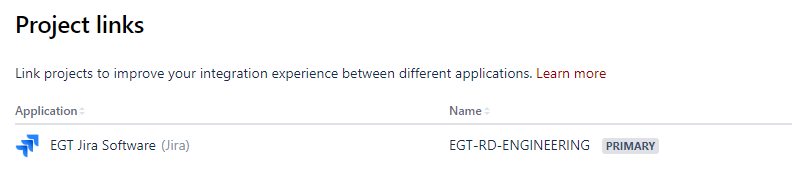

I've connected the 2 projects, this is from the JSM side:
It is a 2-way link, from JSW side:

Hmm I don't see why project links would be necessary here.
Are your JSM and JSW on different instances?
Have you tried typing the first part of the project name? Because I do see "Engineering Division" in your dropdown and also in your project links.

"Have you tried typing the first part of the project name? Because I do see "Engineering Division" in your dropdown and also in your project links."
- Engineering Divison is the name of the JSM project, whereas EGT-RD-Engineering is the name of the JSW project. I've tried typing it, it does not appear.
Licence EGT
May 22, 2023
And because they are on different instances I guess I will have to use webhooks.
The automation tool can create issues only in its own instance.
