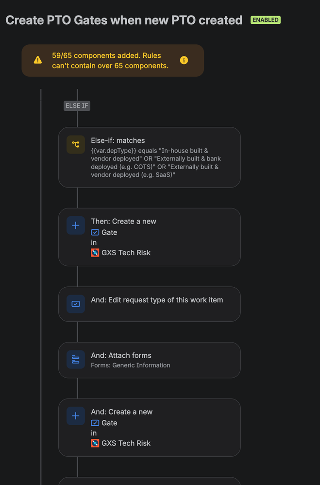

When Asset is in 'In PTO Review', it will create a new PTO ticket. The creation of PTO ticket works, but the creation of the child work items doesn't. For PTO, the PTO ticket will be the parent ticket and the Gate (issue type and request type) is the child work item and will be nested in the PTO.

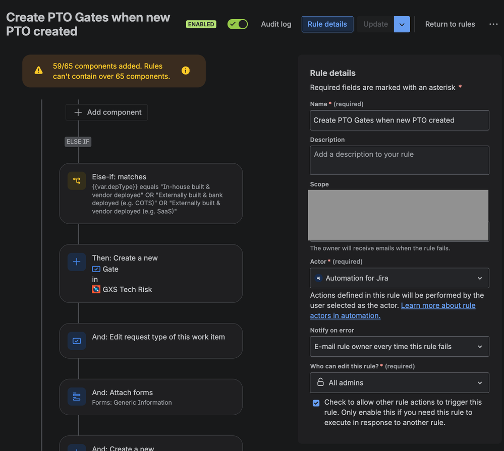

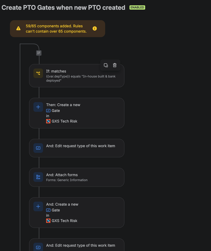

Now, in order to tell the rule on how many child work items to create, the rule need to see the Deployment Type field value in the Asset ticket. If it is Internal, it will create 13 Gates, if it is external, it will create 10 gates. How do I set this up?
I currently have this as my rule set up but no child tickets are created. The end goal is to have the child work items created and nested in the PTO parent ticket.

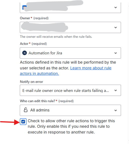

Also, as PTO tickets are also created from Automation for jira, can you check the Rule that is creating Gate child tickets, has "Check to allow other rule actions to trigger this rule. Only enable this if you need this rule to execute in response to another rule." Enabled in Rule Details?
hi @Akhand Pratap Singh yes that understanding is correct. yes the box is enabled, but the Gate still doesn't get created.

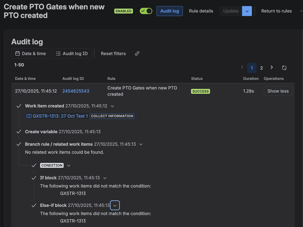

@Nur Fatin , Can you share the Audit logs once?
Want to check if the rule is even triggered and if triggered where it stops.

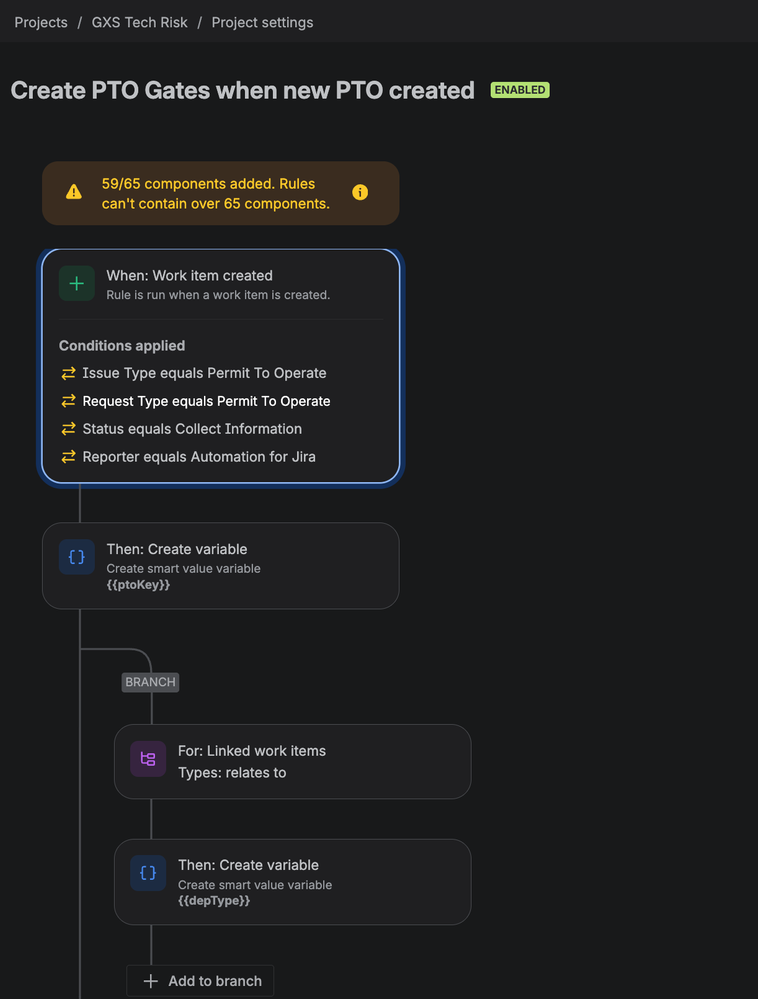

Also Quick Question, When PTO is created, Automation is updating the Request type.
My guess is as you have added request type in the create Condition, this rule is triggered before the request types is updated.
Move that condition out from the triggered and add a separate condition for this at the same time if you are using Request type condition, add 2 action before this condition that is Delay and re-issue
@Akhand Pratap Singh it says success but no child work items created. can you show me which part i should edit, please? based on my previous screenshots. sorry, i didn't catch that
@Nur Fatin , From your screenshot it says, no related work items could be found, why are using using branch here?
If you have already defined issue type at the beginning why using branch, as there is no issues found it doesn't work, also conditions didn't match.
Suggestion would remove branch if not needed and check your conditions once.
NOTE: It is showing success but it is not, it is not creating any work items as branch and conditions are not fulfilled
