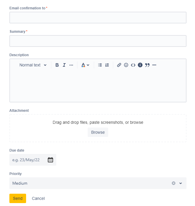

I want to create an issue without a user login.
I am using:
https://mycompanyname.atlassian.net/servicedesk/customer/portal/3/create/86
endpoint with POST action and x-www-form-urlencoded body with such values: (keyValuePairs):
email - "fake.email@test.com"
summary - "test"
priority - "3"
projectId - "ourProjectId".
After the post request, I got the invalid captcha - errorMessage: "We couldn't verify that you're not a robot. Try sending the request again."
What could be behind this?
Thanks

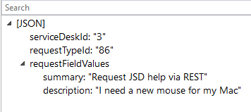

I tried to follow provided documentation, but I got unauthorized 401 response.
Endpoint:
rest/servicedeskapi/request
Json body:
What could be reason behind this?
