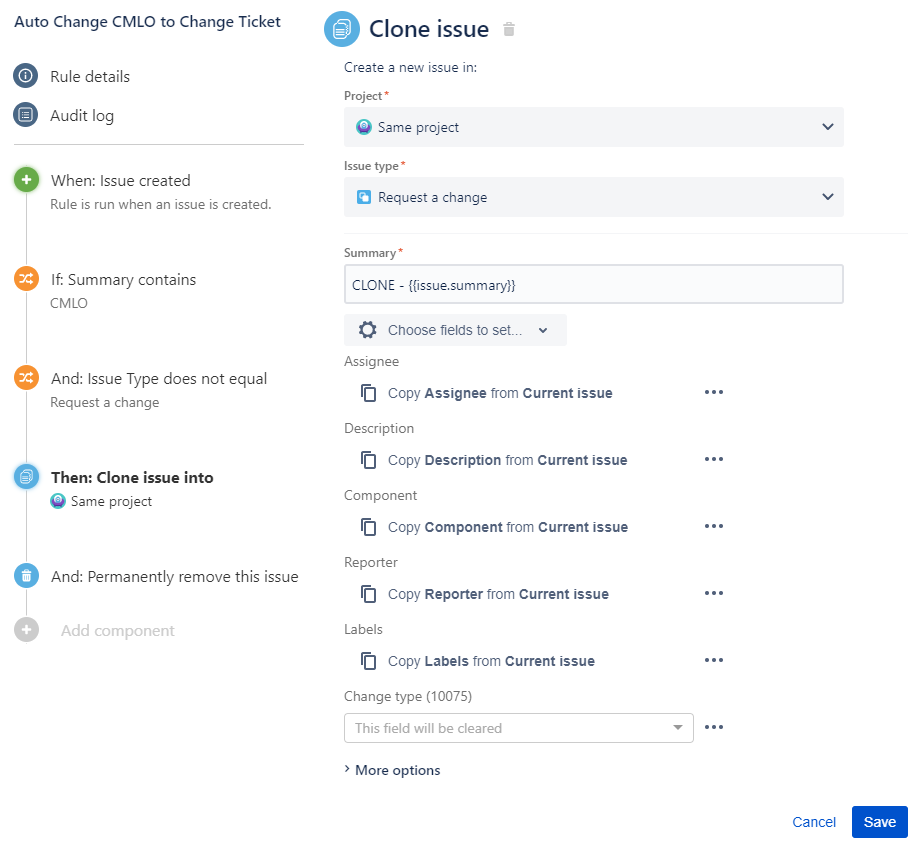

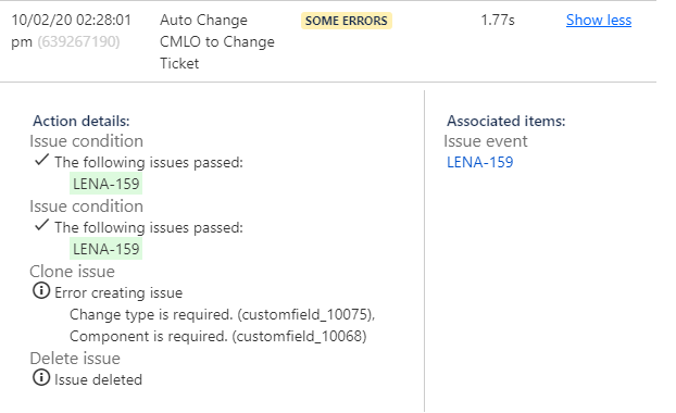

Attached is an image of the Automation and the error I am getting as well.
Interestingly enough the Component in the Automation is apparently not the same one as the custom Component (10068)

Additional to the information you found, I noticed another incoherence in your problem: The system field available for Jira is called "Components" and not "Component".
That being said, the Component field you are adding to the issues in the automation and causing the error is a custom field manually created by someone in your instance. That being said, I recommend you to check why this field was created and what values are applicable to it under Jira settings > Issues > Custom Fields > Edit details.
Once you check it, you will have two options:
- Edit your automation rule to provide a valid value to the component field (Since your current rule is not working, I believe the component field is not being filled in the Original issue from where the new issue will be cloned from, so a new value must be added to it)
- Remove the Custom field from the project where the issue will be created.

Chris Koehler
February 11, 2020
Hey Petter,
Thanks again for your assistance, you are fantastic. Thanks to your help I discovered what the issue was and was able to resolve it actually! It turns out it was not in Jira settings > Issues > Custom Fields but it was in My Project > Project Settings > Request Types > Fields. It was a custom field I had created in my Next-Gen project. I had created a component field to log what the component affected in the ticket was and had forgotten it was a custom field. I deleted the field and then with a few tweaks the automation was running!
