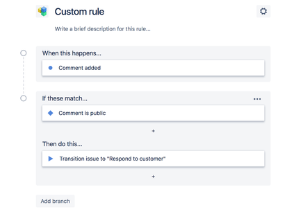

Hello Cole,
You just need to add a condition requiring that the comment should be Public, as in the screenshot below:
Hello Petterson, my apologies about my delayed response!
Thank you immensely for this answer, it worked perfectly. Thank you again, it is much appreciated!
