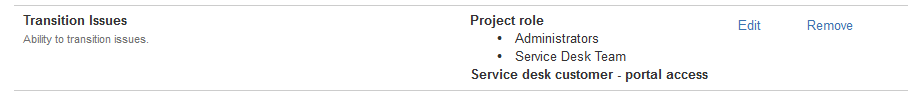

  • permission "transition issues" is granted to "Service Desk Customer - Portal Access"

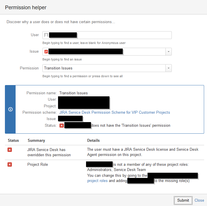

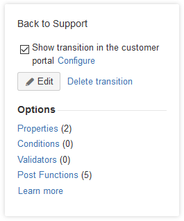

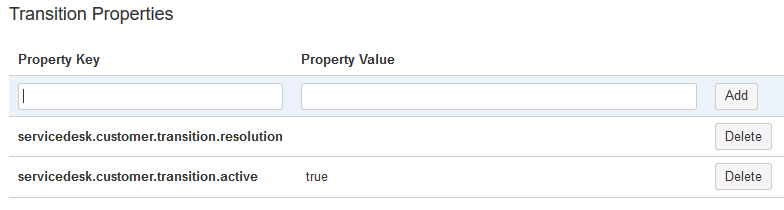

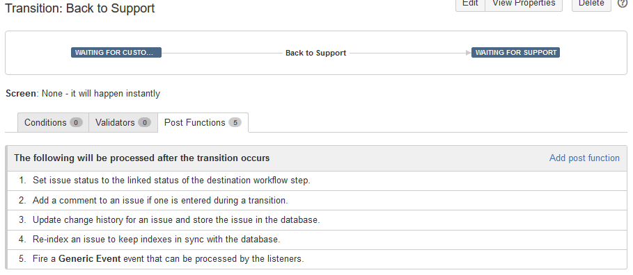

Please see also attached screenshots:
_________________________________screen02.png_____________________________________screen03.png______________________________________screen04.png_____________________________________
_____________________________________screen06.png______________________________________

Victor Mutambuki
September 17, 2018
H K,
Issue is in the permission scheme as shown in the last attached image. As you can see, the indicators are in red. It clearly shows that the user needs JIRA service desk license and Agent permission in the project. Also, it shows that the user is not a member of any of the project roles. Please review.
Victor
H K
September 17, 2018
Yes, I can see that. But as a customer he should not get an agent license, that is NOT what we want!
The user is in the project role "Service Desk Customer" and the permission is granted to "Service desk customer - portal access". Therefore this permission should apply, right?
