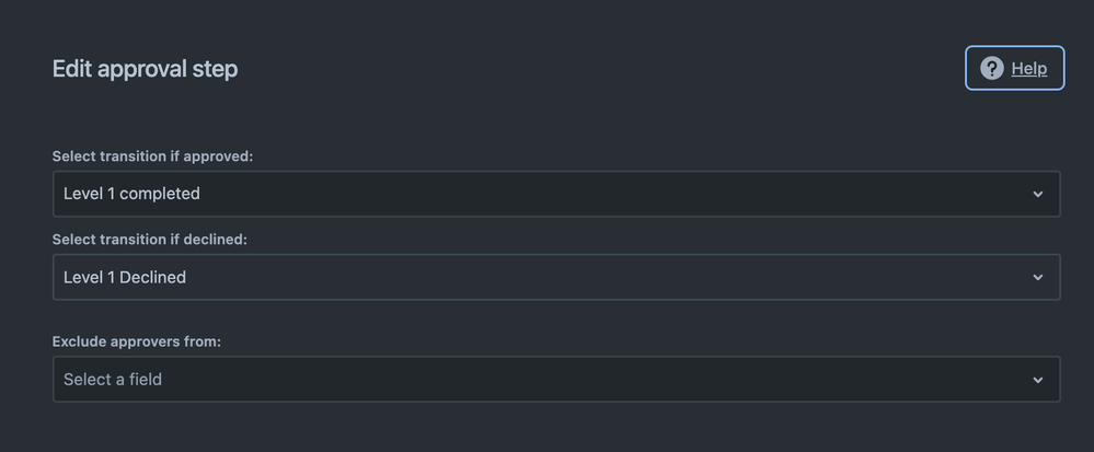

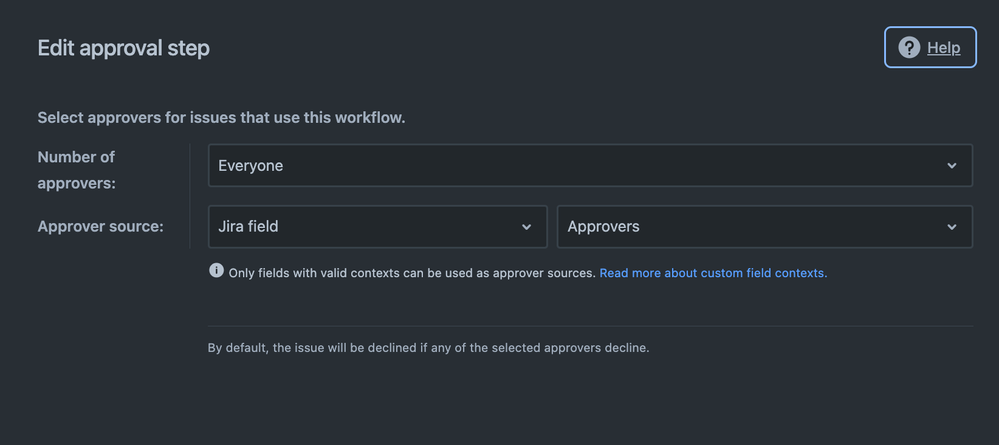

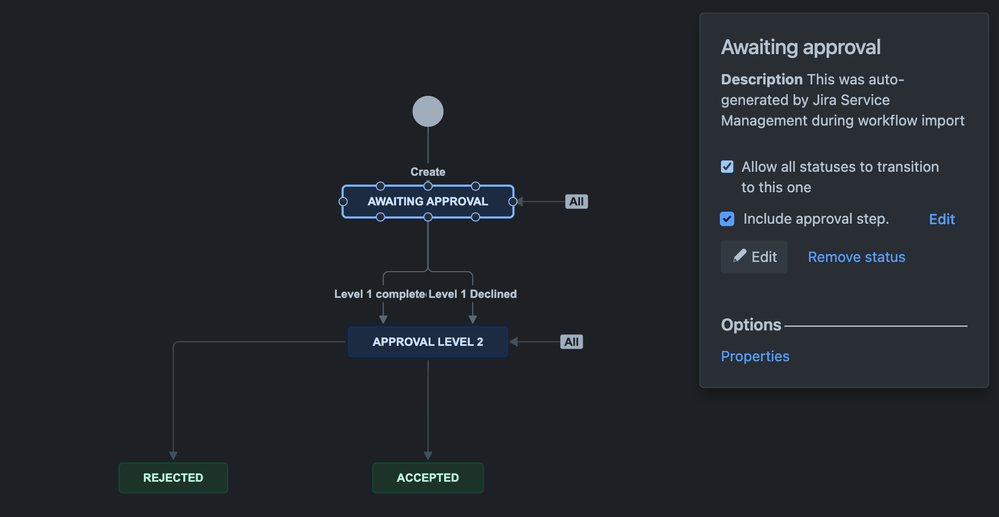

My team and I have tried and haven't gotten approval level 1 to work yet. Here's what we have tried ("awaiting approval" is what I am referring to as 'approval level 1'):Screen Shot 2024-04-22 at 11.25.11 PM.png
Screen Shot 2024-04-22 at 11.24.17 PM.pngScreen Shot 2024-04-22 at 11.24.27 PM.png
The level 1 approval step is set to 'everyone' for number of approvers, both transitions for approve and decline point to approval level 2, with validators on both so "Issue transition will be blocked if there is a pending approval."
This is working as expected if the first person in approval level one approves...it doesn't advance until the other level 1 user approves or declines. The problem is when it is declined by the first approver in level one...it'll advance to approver level two, even though the other level 1 approvers haven't responded yet.

Can you share a screenshot with the details of the Approval/Decline on the Status?
Amorena Simpson
April 22, 2024
Ok updated post with screenshots!
John Funk
April 22, 2024
So, you have the Decline going to the same Status as the Approved. That's not normal or the way the Approval process is is designed in Jira. The thought is that if anyone Declines, it's dead and doesn't move forward. So you typically will see the Decline going to a separate Done type status like Declined or No Approved or something like that.
Bottom line is that when the first Decline happens, it's going to move to a Status.
