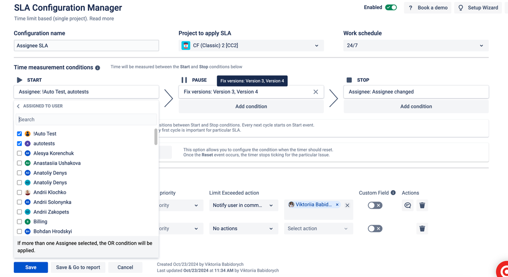

  • Configure the SLA goal for the Assignee SLA to start whenever the issue is assigned to a new group/assignee and stop when the assignee is changed.Знімок екрана 2024-10-23 о 12.46.54.png

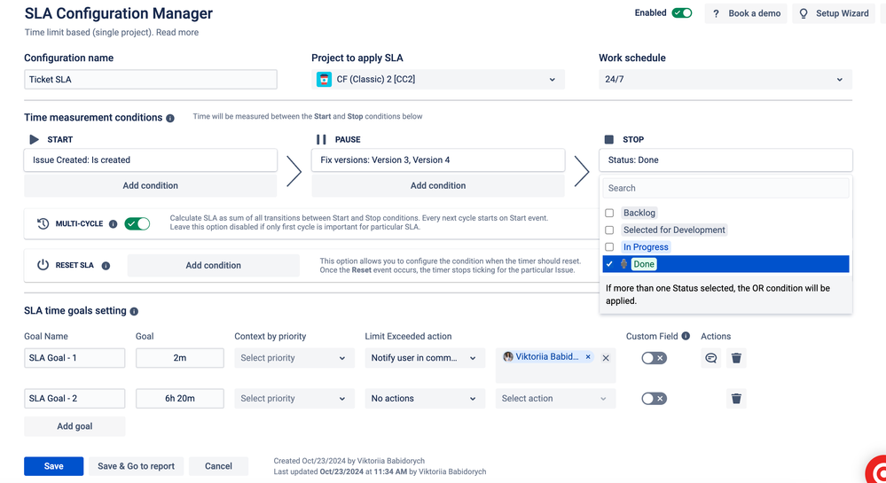

  • Configure the Ticket SLA to track the overall resolution time, ensuring it reflects the total time for the entire ticket lifecycle, regardless of assignee changes.Знімок екрана 2024-10-23 о 12.47.51.png

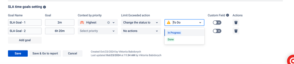

4. Set Up Automation Rules actions:
  • You can create automated action to change status or reassign to anouther user if SLA is breached or nearly breached.Знімок екрана 2024-10-23 о 12.49.53.png

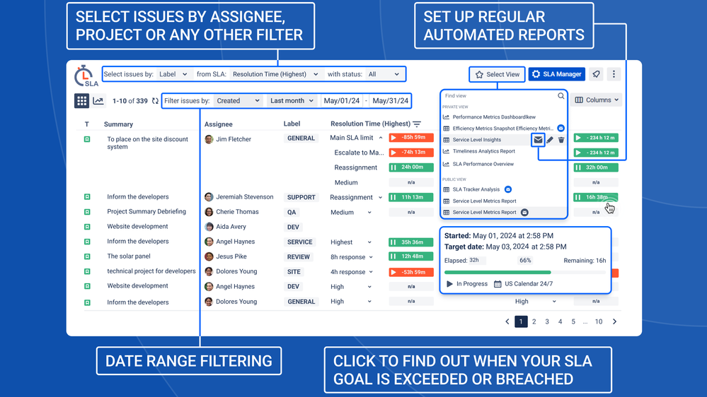

6. Create SLA Reports
  • Use the reporting functionality in SLA Time and Report to create detailed reports showing:
    • Group, Current Assignee, Assigned Date, and the status of both the Assignee SLA and Ticket SLAJira Service Management  vs  SLA Time and Report - 54.png

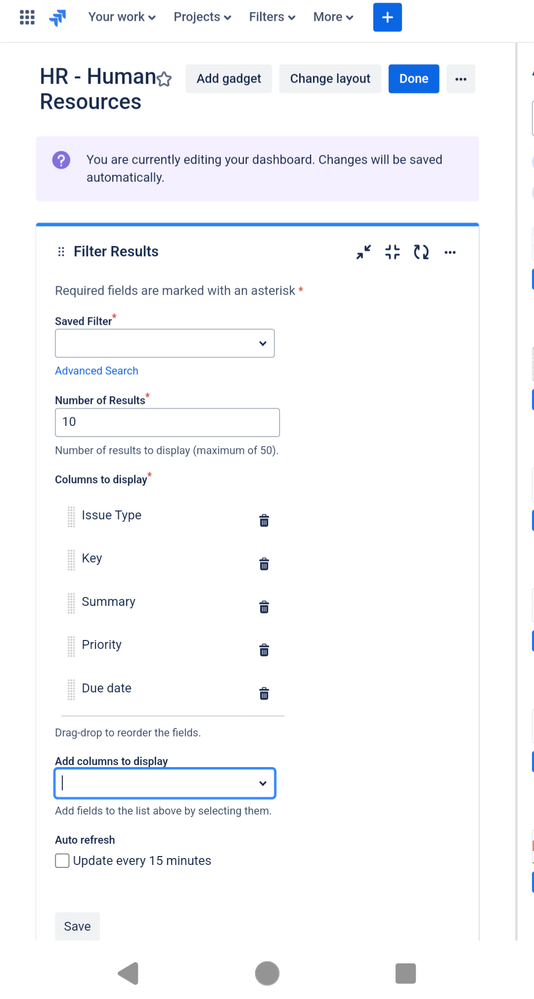

Thanks Valerie. Actally, I have achieved whatever the result your link is showing. Can You assist me for one point. I want to see the all changed status for the same issue along with date and time in a list view? If you assist on this then my problem will be resolved almost.
Valerie Knapp
October 13, 2024
Hi @Amit.Kumar3 , thanks for your feedback. I'm just using a Filter Results gadget with a filter for the issues in scope with the columns configured to show the Due Date and the actual transition date. I don't know if that will be enough for what you're trying to show.
