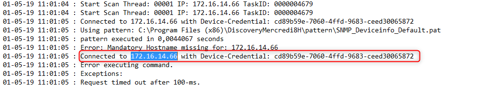

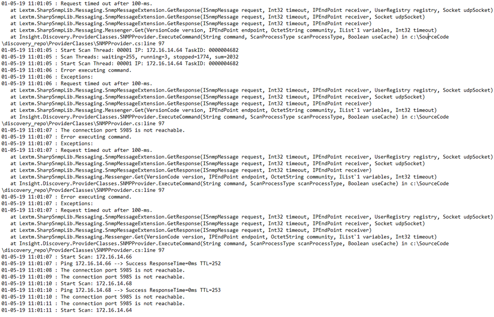

Hi everyone,
I'm new with using discovery and Insight.
after many tests I see too much basic information when I scan network printers, linux servers and switches using snmpv2, v3 and shell. The credentials are correct though. Here I present part of the logs file showing that I scan a network printer and that the credentials works, discovery is connected. But then for the same printer and when retrieving the information the credentials no longer work and I only get the basic information.
I don't think it's a normal behaviour. How could i change that?
Thanks for your response.

Hello,
I have the same problem here.
I'm in the process of evaluating Insight and Insight Discovery.
I manage to get SNMP informations from our printers.
From what I see, even with correct credentials (successfully tested on the same couple server-printer with OIDVIEW and Paessler SNMP Tester), Insight Discovery reports "No working credentials for...". No problem with other printers like Lexmark.
Version of Insight: 2.20.
If somebody of Riada come into this thread, is he/she have an explanation on this behaviour and how to resolv it?
