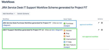

you will want to create two workflows (one with approval and one w/o approval). Then you will have to create Issue Types and assign them to the appropriate workflow. In this way when the customer opens a request they will need to specify the issue type. If the customer chooses the incorrect issue type or uses email to open an issue that requires approval then the agent will need to move the issue to the issue type that is associated w/ approval.

Are you using Cloud version? If so please read the following document - Workflows.
It may seem complicated on the surface but it really is not. You can use the default workflow for the non-approval and then create a new one w/ the approval steps. Then simply go to the settings/workflow and add the workflow there and choose the issue types. In the image below you will see an example of this.
