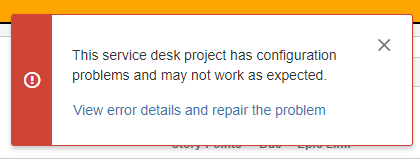

Error when issue is created configuration is not supported?
This is the error I see every time I log on at this point. If I click the hyper link, it brings me to another error screen.

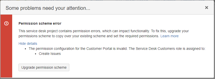

Mandatory permissions by project roles
The permissions for customers must be granted to the Service Desk Customer - Portal Access security type instead of the Service Desk Customers role. This configuration gives customers access to the Customer Portal only (not JIRA). The security type reads the role to determine who are customers.
https://confluence.atlassian.com/jirakb/using-custom-permission-schemes-838416400.html?_ga=2.221799647.674697376.1543223820-899529972.1531837689
So basically it says that create issue permission should be granted to Service Desk Customer - Portal Access not to Service Desk Customers role.
So there would be no confusion you can add more groups or single users etc. to create issue permission scheme, but not Service Desk Customers role
