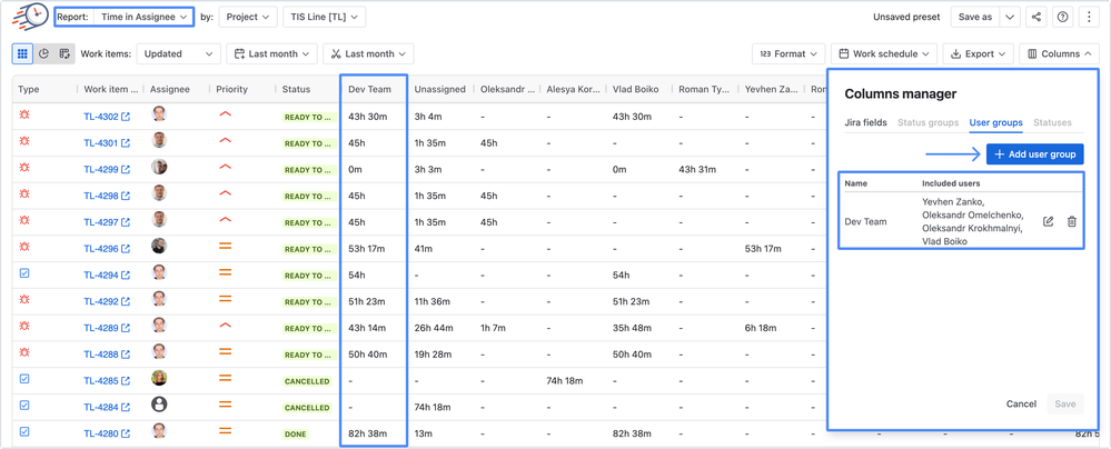

If you are open to apps, Time in Status (developed by my team) provides a Time in Assignee report that can help with this. It shows how long a work item was assigned to specific people within the report period; totals show combined assignee time, so you can quickly spot cases where:
👉 a ticket had multiple assignees
👉 ownership kept shifting between teams
Although it does not directly show the number of reassignments, it provides a clear picture of how work is allocated, which is a strong signal of “queue bouncing”.

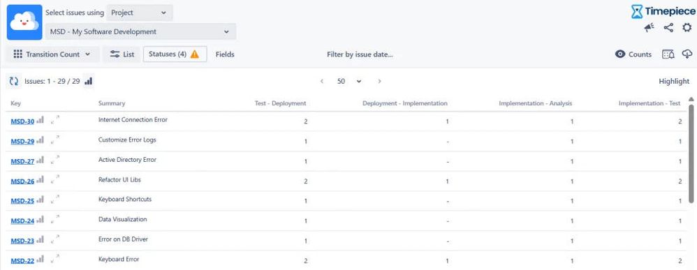

For this exact metric, a dedicated reporting app is the most reliable solution. Full disclosure, I'm on the team that makes Timepiece - Time in Status for Jira, and we have specific reports to extract this data.
To find tickets that are bouncing around, you can use our Transition Count report. If your different queues are represented by workflow statuses, this report will instantly show you a clear table of exactly how many times a ticket jumped from one specific status to another.
If your queues are based on assignment changes rather than statuses, you can use our Any Field Count report to see exactly how many times the "Assignee" or "User Group" field changed for each ticket.
This gives you the precise metric you need to identify "bouncing" tickets without any manual spreadsheet manipulation or empty data exports. You can check Timepiece on the Atlassian Marketplace.

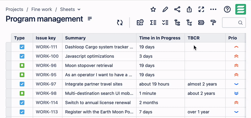

If you're open to using an app from the Atlassian Marketplace, JXL for Jira solves exactly the problem you described. JXL provides history-based columns that you can add to a spreadsheet view, including "Number of times in [status]," "Time in [status]," and "Time with [assignee]." You can sort and filter by these columns to quickly identify which tickets are bouncing the most, then export to Excel for further analysis.
Disclosure: I work for the team that builds JXL.

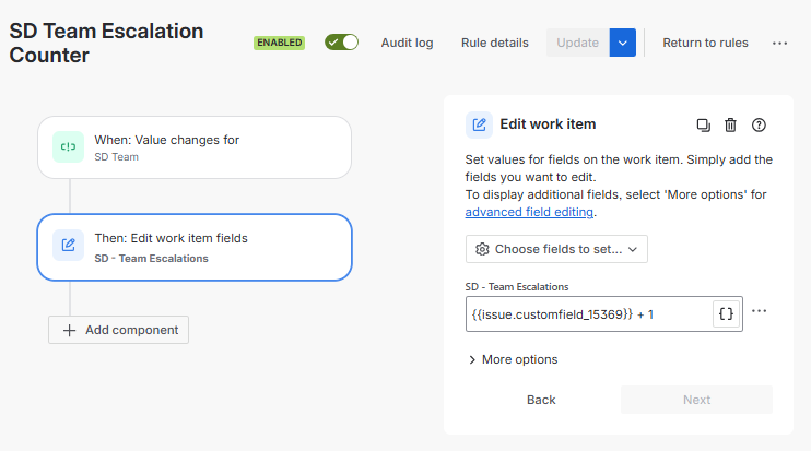

Our team queues align with a custom field so we track this using an automation rule that adds 1 to the counter each time the value changes for our team field
The custom field ID is the field itself so it just adds +1 to the value each run
