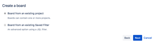

Jira Service Desk does not have the boards functionality, so it's not possible to create a board directly in the project, but you can create a board that will be linked to your profile.

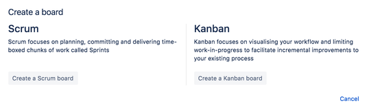

Please, open any software project and click on "Create board" > Create a Kanban board > Board from an existing project.
Screenshot 2018-11-19_10-22-30.pngScreenshot 2018-11-19_10-23-51.pngScreenshot 2018-11-19_10-24-03.png

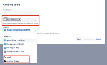

Then, choose the board name, choose the desired SD project and on Location, you will select Personal which will appear your name and then click on "Create board".

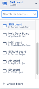

To find your boards, as it cannot be accessed through SD project, you must click on your profile picture on the bottom left > Your boards.
