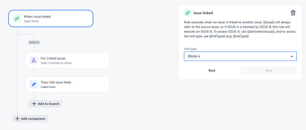

Ahmed Aftab
January 8, 2024
Hi @Ravi Sagar _Sparxsys_
I am facing a similar problem.
The linked issue trigger only works when issue link "Blocks" is used. For cases when the issue is linked as "is blocked by" the automation rules don't trigger at all.
It is mentioned in the linked issue trigger that rule will always refer to the source issue. I am unable to set it for destination issue.
Your help in this matter is highly appreciated!Screenshot 2024-01-08 132832.png
