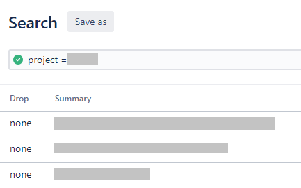

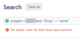

I have a field named Drop that I'm using in my data analysis and I use JQL to filter its values. When I want to filter the value "none", i get the error The option 'none' for field 'Drop' does not exist.
This was also reported here but the workaround found by the reporter doesn't work in my case.

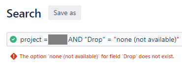

Apparently "none" is actually "none (not available)" and there is also a "None" option. However these can't be accessed through the JQL either.
