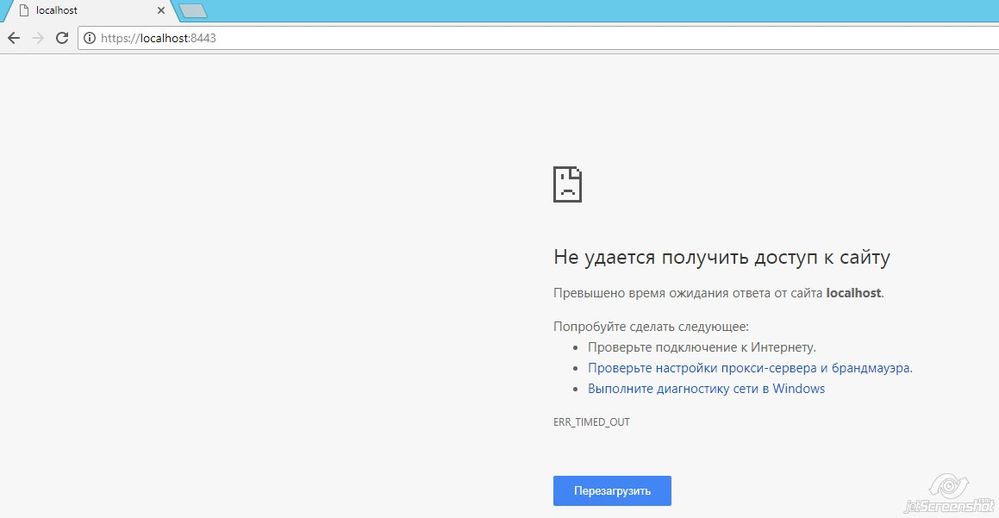

Indeed, the service ceased to stop, but access to the web interface was lost2017-08-17_10-54.jpg

I tested your server.xml with 4 changes from the file you provided, and it started just fine with the exact same JIRA version.
org.apache.coyote.http11.Http11NioProtocol, keystoreFile, keyAliasand keystorePass.
Check that keystoreFile, keyAliasand keystorePass are correct, and that the user has permission to the file.
Check atlassian-jira.log and catalina.out to look for clues.
ABRIKOS August 20, 2017
Lars, thank you very much, it worked out!
