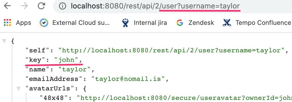

Alexander Eck [Tempo]
October 21, 2020
Hi Gleb,
have you confirmed the username/userkey against the Jira REST API?
Like # people like this
