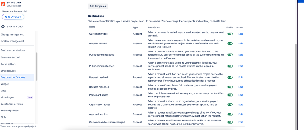

Hey @Oluwaseun Adedeji  glad to hear! Is it only one user that is affected? Within your project settings you have the option of Customer notifications.
If everything is checked and they are still not receiving the notifications, then it could be that their email address is on the supression list from Atlassian side. In that case, you should raise a ticket on Atlassian support site:

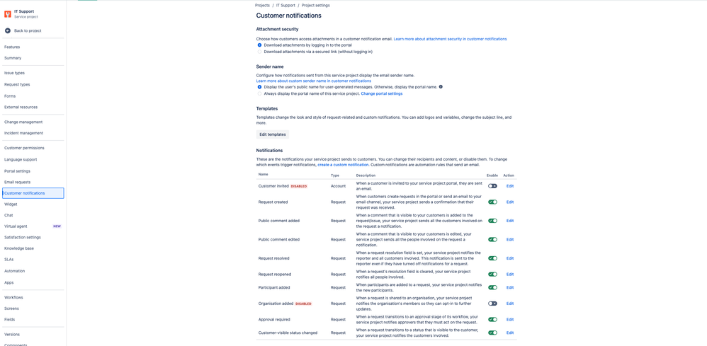

Hello @Nikola Perisic Not just one person about two to three people. And there are two settings that are not checked. Do you think those two could be the issue?Screenshot 2024-02-12 at 12.36.58.png
Nikola Perisic
February 12, 2024
Hi @Oluwaseun Adedeji if other people than other three people are not being affected by this issue, then it is not the problem from the settings perspective, rather from the supression list.
