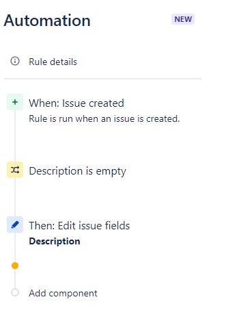

Anyway, as a workaround, I would create an automation that fills your custom field with your input if it is empty.
Would this work for you or did I misunderstand your request?

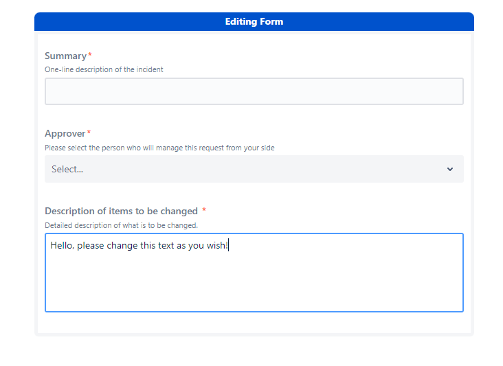

I don't want the default text be visible after the ticket is created, but before.
Like: Someone opens the customer portal, clicks on a request type and the description field is populated with some text ("We need the following information from you: bla bla"). Then the person can edit the default text and finally create the ticket.

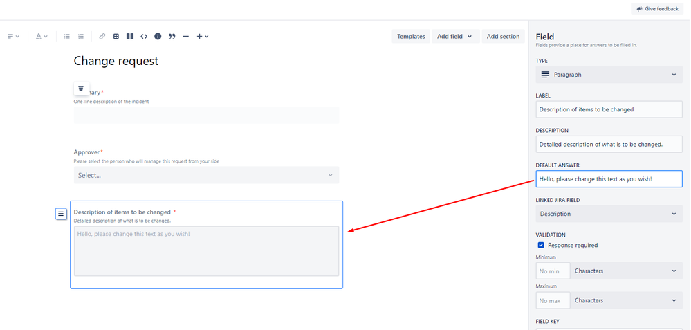

It sounds like you might benefit from https://support.atlassian.com/jira-service-management-cloud/docs/what-are-forms/
However, I do not recommend using a default answer, but instead explaining it in the description of the field.

For DC the "ProForma" (Now Forms for Jira) remains in the marketplace https://www.atlassian.com/licensing/proforma
In that case, I would recommend that you stick to the field description in Request Types -> Request Form -> "Your Field" and make it mandatory. In my experience, this is better because the customer has all the information in the field description on the portal and cannot proceed without filling it in. From my point of view the result is the same, do you have a different opinion?
