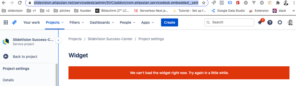

On my site, the URL doesn't contain addon/com.atlassian.servicedesk.embedded__settings.
Below is the URL that shows on my site, can you please change the name and the key and check if the widget loads:?

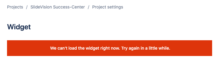

I was going to Project > Channels > Widget and getting the "We can't load the widget right now. Try again in a little while." error.
When I go to Project Setting widget I get the same under this uri:
https://slidevision.atlassian.net/jira/servicedesk/projects/SVC/settings/widget
...maybe you can just reset our hole service desk instance? ...I m willing to do all adjustments a second time, but I have to make progress with the transition?

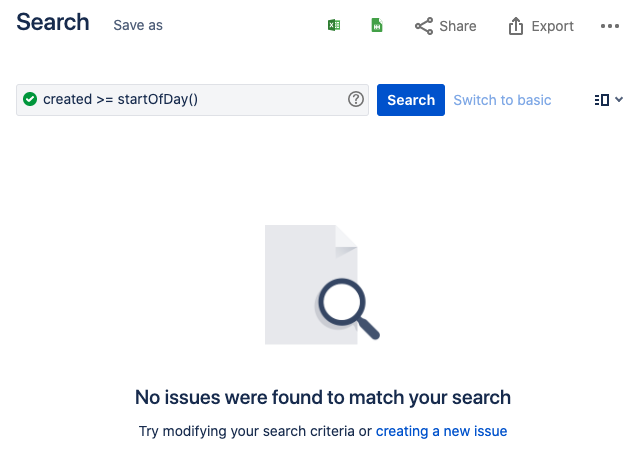

if instead of using the queues, you go to the filters -> advanced issue search and do a search of created >= startOfDay() do you see the tickets (or at least mine) there?

I did what you suggested, but nothing is showing up. We also have only one project so no chance of having the wrong project widget.
I attached a screenshot - you maybe have another idea what I could made wrong?
Thanks
Tom
So it seems it really never gets created in that instance. (the search doesn't specify a project so even if it were in another project you would see it now)

Really something changed - in the widget settings I see now "We can't load the widget right now. Try again in a little while."

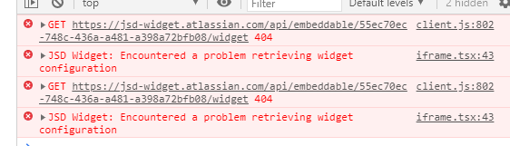

On the website http response code is 404 - in jira service desk is answering with http code 409 - conflict - just for completeness.
I feel like there might be more going wrong with the widget channel right now then.
I'll see if I can get someone from Atlassian to take a look at this directly.
