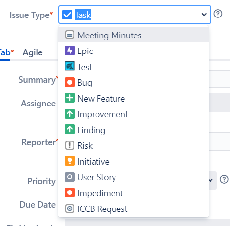

3. I am trying to create a task/subtask -- under a Initiative.  After checking the above I noticed that "Sub-Task" is not a option, so I changed it to "Task" but now validate itself fails
I noticed that "Sub-task" is not a option here,  so I checked it to Task and now validation fails with this

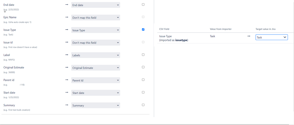

Are you ticking the box next to "Issue Type" and mapping what's in the CSV to what's in Jira? You need to do this for every field that has preset values (such as Resolution, Assignee, Select List fields, etc.)
auj012
January 26, 2022
yup I did that, please see this screen shot.
  • Issue 'First test bulk creation' doesn't have Subtask Issue Type, its Parent Id mapping will be ignored.

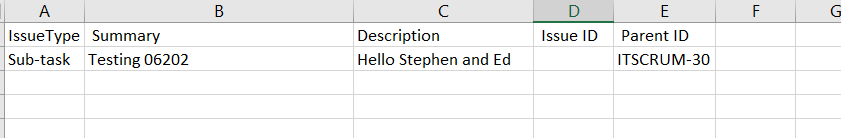

@auj012 -

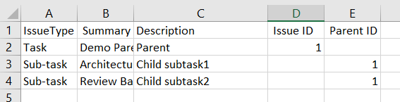

Welcome to the community.  I agreed with @Dave Theodore [Coyote Creek Consulting]  statement.  If your EPIC issue is already created in your project, then you will need to add the Epic issue key in the Parent ID column.
However, if you are creating the parent/child issues in a CSV file at the same time, then you can just provide the parent ID and not the issue key.
Example -
Hope this helps.
Best, Joseph Chung Yin

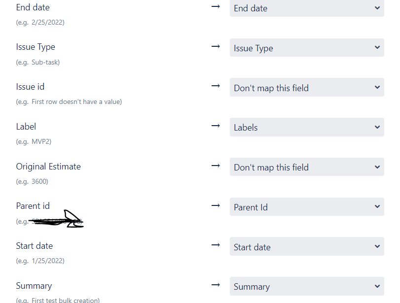

auj012
January 25, 2022
Hi Joseph
  I did , please notice the first column.

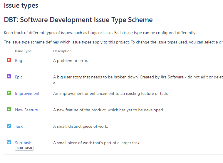

@auj012 -
Based on your response to @Nic Brough -Adaptavist- , The problem is with your parent ID field as "-118" is not valid.
image extracted from your reply -
As mentioned by both Dave and myself, your CSV file parent ID cell need to have the actual EPIC's issue key (i.e. ACME-118 where ACME is the project key with the issue number).
If that was fixed, when you map your CSV to the fields via the import process, you can should see the issue type (Sub-task) in the mapping screen.
You should also check your project's issue type configuration scheme to ensure that Sub-tasks issue type is there for your project. (Project settings >> Issue types)
You will not see "Sub-task" in the create issue screen, since you cannot create a Sub-task directly via the Create Issue button.
Here is an example of the issue type configuration scheme
Best, Joseph
