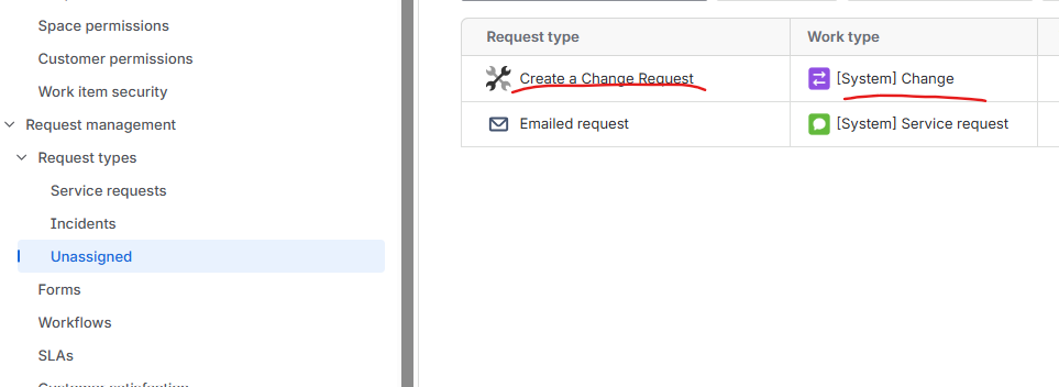

@Susan Waldrip Thank you for your response and as I understand you correctly, the existing form for Change request available in the portal for customer stays the same? Once the customer raise a Change request this will follow the same workflow, and this case will be put in All Queues? Where is this "All Queues" located? I have removed this Change management feature from my TEST project and I do not see all these CR's in any queue. The only change I see is that this request type went to Unassigned request typesCR.png
My main concern is, what do I need to do in order to have clear visibility to all existing cases and these raise in the future? Do you have any screenshot presenting when they are going to be located after Change management feature removal?

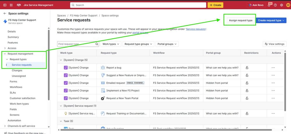

1. Space (Project) settings > Request management > Request types > Service requests.

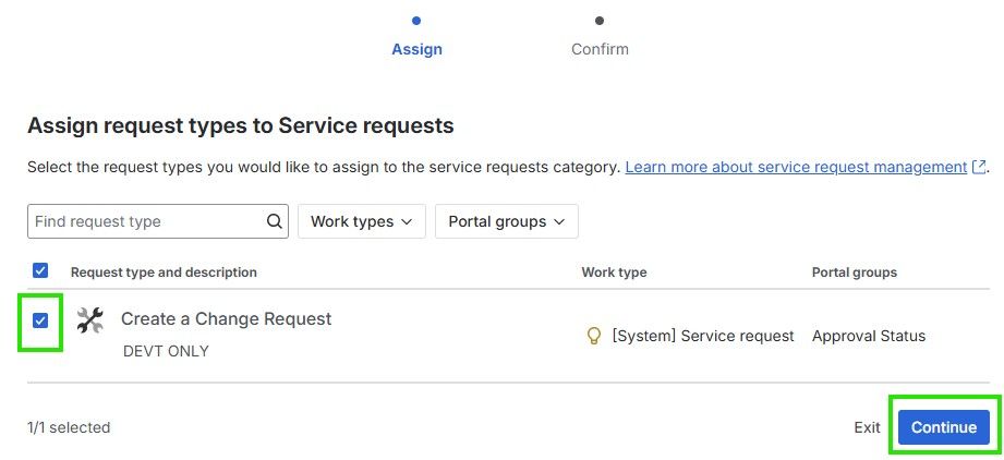

2. Click the Assign request type button (upper right of the screen).

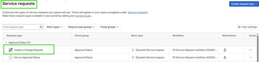

3. Check the "Create a Change Request" Request Type checkbox and click Continue. You'll see the Work Type for this Request Type change to "[System] Service request".

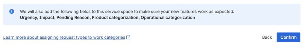

4. Click Confirm. Note that this action will add fields to your screens that you may not want, so you'll have to remove them from your Field Configuration Scheme and/or Work Item Screen Scheme screens (Create, Edit, and/or Edit/View).

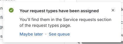

You should get a fly-in message saying "Your request types have been assigned. You'll find them in the Service requests section of the request types page."
The "Create a Change Request" Request Type should now be assigned to the "Service request" Work Category, and all the work items (requests) that Atlassian moved to the "Unassigned" Work Category should now be under the "Service request" Work Category and available in the queues.

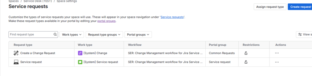

@Susan Waldrip Thanks a lot for your detailed explanation. I have followed your guide, but in your case you have work type Service request and I have still Change request
How should I change it? and can I still use the same worflow for Change request while moving this into Service request?

Mariusz Mika
November 13, 2025

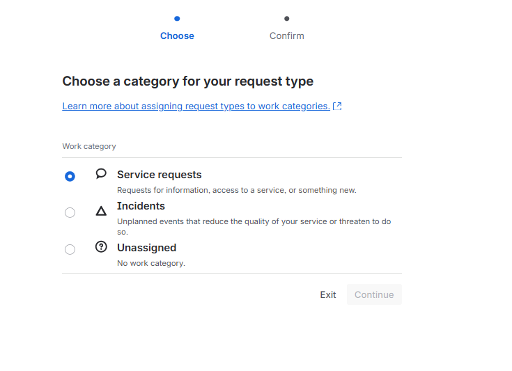

@John Funk I am trying to assign Change request to Service request category per Susan's guide. As you can see on the previous screenshot it is under Service request, but still with Change work type. How to reassign it in order to have it in the queue os Service requests? And is it possible to reassign it under Service Request and still keep the workflow I use for Change request?

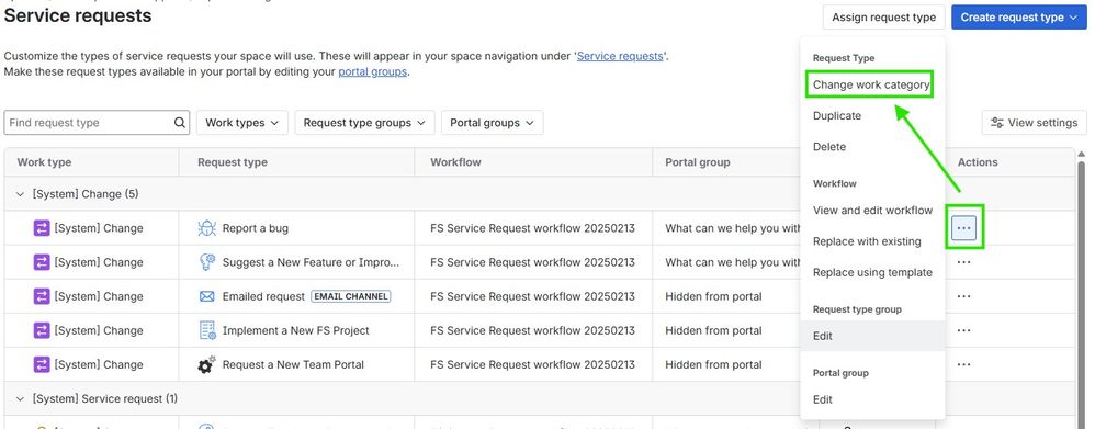

@Mariusz Mika , based on your latest screenshot, did you try clicking on the Actions ... button for your "Create a Change Request" Request Type? Below, I've clicked the Actions... button for my "Report a bug" Request Type, but your R-Type would be "Create a Change Request".

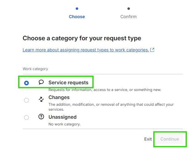

And again, if so and you click the "Change work category" option, does the pop-up screen allow you to select "Service Requests" like the screen below? (The Continue button would be blue/active, in your case)?
OR is the problem that you don't have a Work Category called "Service requests"?

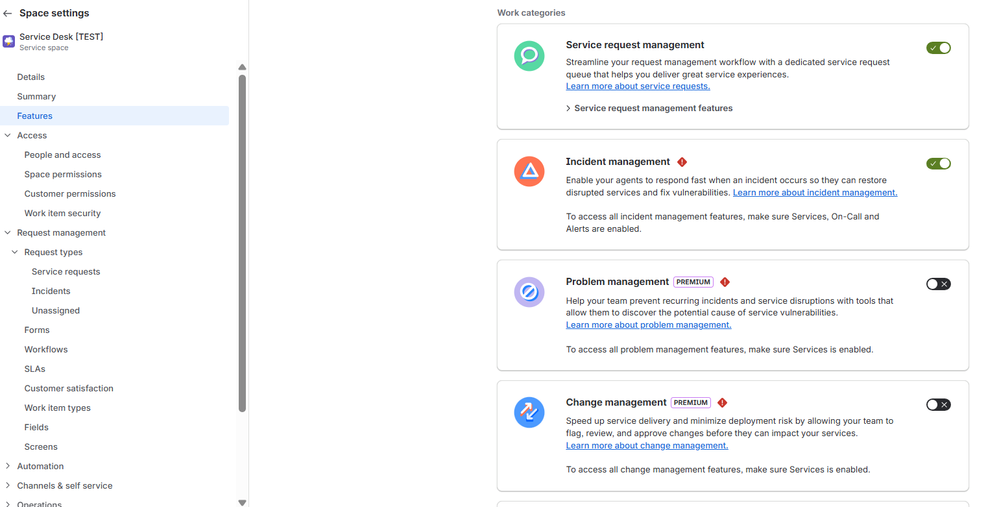

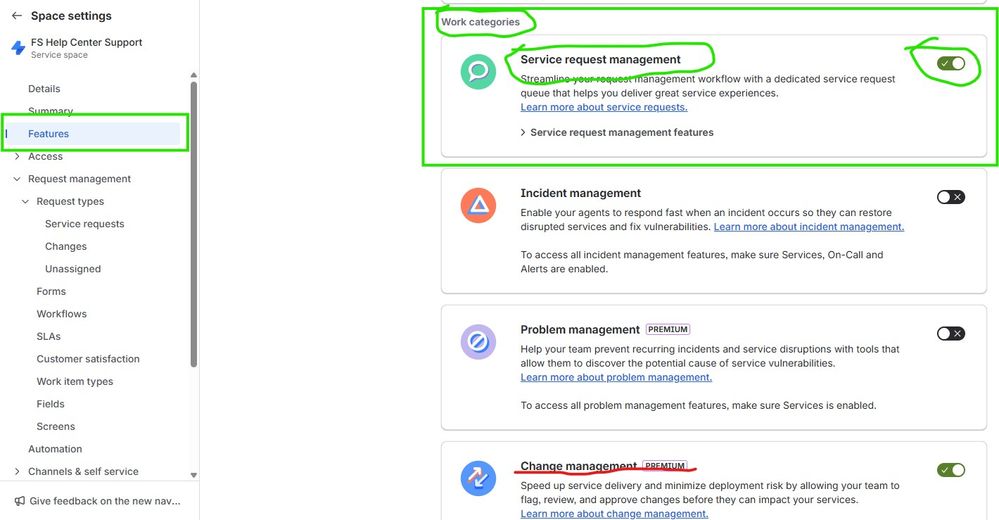

If that's the case, would you please
1. Go to Project settings > Features, scroll down to the Work categories section, and make sure "Service request management" is turned ON.
2. Post a screenshot of your Project settings > Request management menu tree, like the left side of the image above. That may help us understand the problem better.
Mariusz Mika

@Susan Waldrip Service management feature is on

And when I try to Change work category from Change request to Service request, the continue button is greyed out:

Susan Waldrip
November 13, 2025
Okay, that means your Request Type is already associated with the "Service Requests" Work Category so that part is okay.
I went back and read your last post to @John Funk  and you actually want to ALSO change the Work TYPE from "[System] Change" to "[System] Service request", is that correct?
FYI, you don't have to change the "[System] Change" Work Type if you don't want to because it's not going away in Standard. But if you do, post back and we can tell you how to do that!
