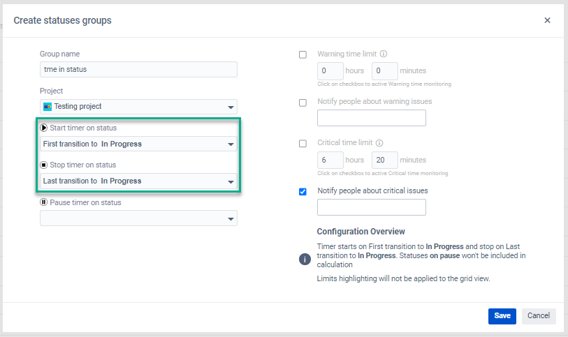

Karolina Wons_SaaSJet
November 29, 2022
Hi @Ali Azzam
Time between Statuses add-on allows you to generate the time spent report for each task. You should set the start and stop conditions in the status group configuration. Having a busy time, you can find a free one by calculating the difference between the busy time and working hours.
