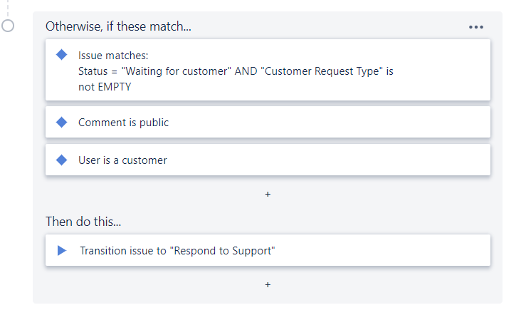

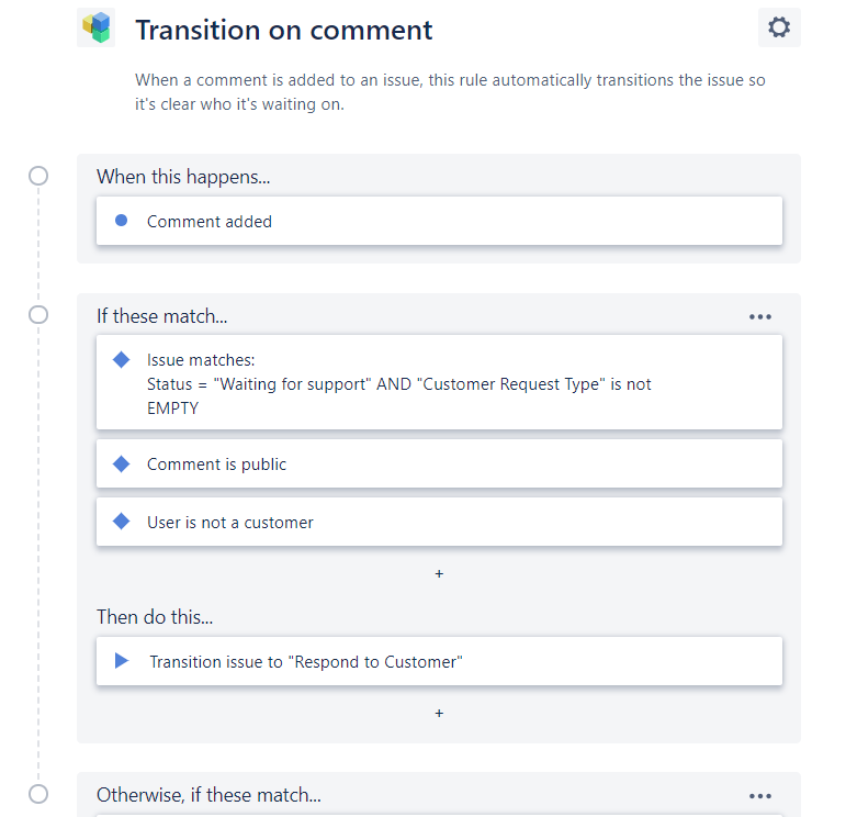

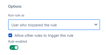

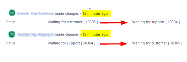

Almut Jenk
September 29, 2019
Thanks for your reply, Angélica.
she is a service desk agent and user, but not an admin. The project only has one automation rule. It runs as the user who performs the triggering action. I'm attaching some screenshots for clarification. The request and issue type are both very common, and only 3 tickets or so showed this behaviour for her in a year, so I'm not sure that's related. It's just very annoying when it does happen, because the ticket will be in the wrong status and the customer will receive confusing notifications.
The first change in the screenshot at the end was manual using the transition buttons and an attached screen to reply to the customer, the second one was automatic (Edit: my Jira settings show the newest entry on top).
