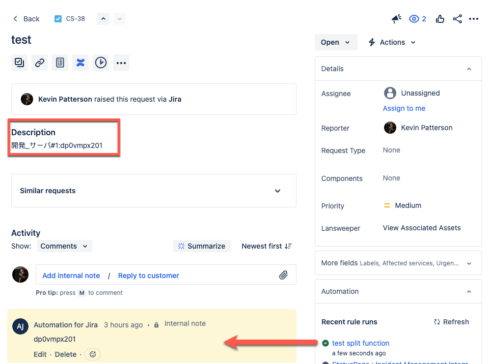

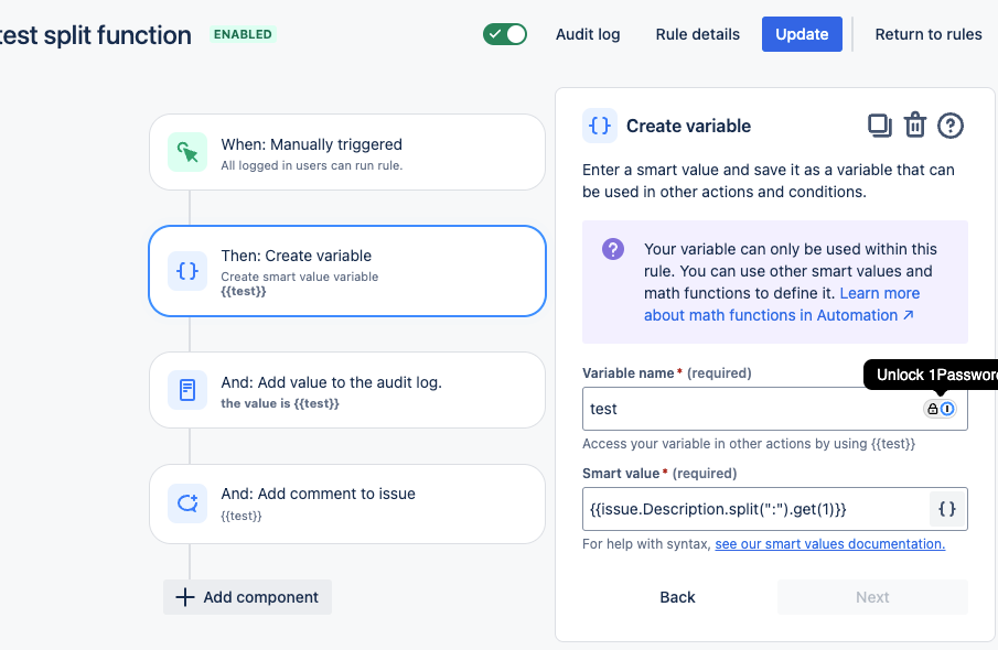

Hi @恩田翔 , if the action setting the smart value is done inside the if conditions and those conditions are not met then this could have an impact. For testing i'd recommend creating a separate automation rule that has a manual trigger and only has the smart value and add comment actions. Once you get this working you can validate that the {{issue.開発環境ホスト名.split(":").get(1)}} extracts the correct value and the move on to troubleshooting your other automation rule.  I've tested this in one of my instances and it looks to be working as expected. for my testing I added your text string to description and configured my smartvalue to pull out the value to the right of the : in the string.
automation rule:
Issue with automation rule populating comment:
