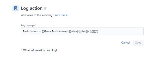

I have followed the documentation for accessing smart values for list items and have tried all the different variation shown here:
Use Smart Values to Access Listed Values
I also tried testing by having it write a log and it's not working.

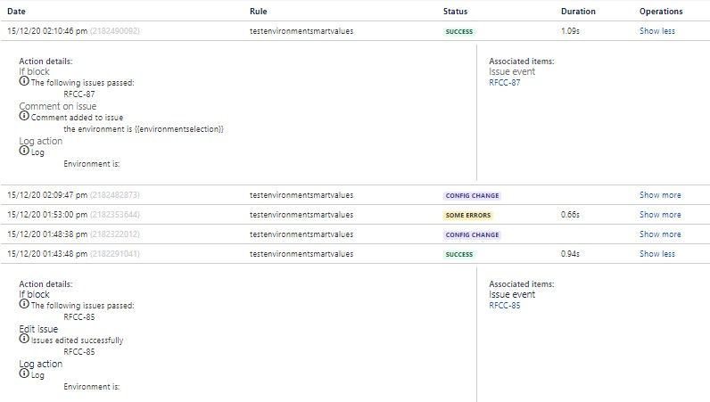

I check the log and it says success and the result is this:
ScreenShotofLog.jpgHere is a snippet of one of the smart value code I used:
The flow is this - A user fills out a support request form in the portal choosing the type of "Environment" and submits.  This is then in the body of the ticket of JSM.  I'm trying to access this checkbox value to populate into a Slack channel message.  No matter what I try, the response is empty.

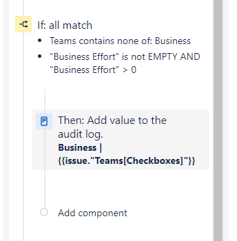

I'm having a similar issue when referencing custom checkbox fields created for Discovery Projects. They don't appear in the instance-wide custom fields section, so I can't find the customfield_xxxx name.
When I build JQL for them, this is the correct format:
  • "Teams[Checkboxes]" is not EMPTY
However, I can't figure out the smart value format. Some options I've tried to no avail:
  • {{issue.Teams}}
  • {{issue.Teams.value}}
  • {{issue.Teams[Checkboxes]}}
  • {{issue."Teams[Checkboxes]"}}
  • {{issue."Teams[Checkboxes]".value}}

Brock Jolet
February 10, 2023
@Darryl Lee Yes, the fields are specific to the Jira Product Discovery project they are created for instead of being instance-wide.
I am having inconsistent results in Automation when trying to access these fields. Some can be selected via Issue fields condition nodes, while others need to be referenced via JQL.
My use case for the smart value is to capture the current state of one of these fields to use later, but I'm hitting a wall just trying to reference it.

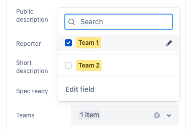

So, I did some actual testing (imagine that!) and created a new Discovery project. Without me customizing anything, I now see this:

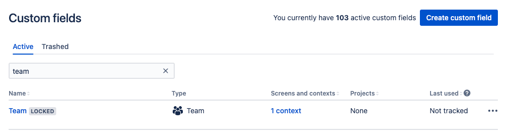

But in Custom fields, I only see this:
Which leads me to believe that "Teams" was auto-created. Anyways, the technique @Bill Sheboy referenced by looking at the API endpoint for a ticket did in fact work, and I found that on my system (this will not be the same for you!) Teams = customfield_10141.

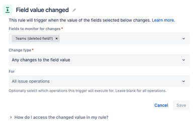

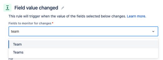

*But also*, I tested Automation and interestingly the "Field value changed" trigger gives me the option of this:
And when I chose the latter "Teams", I was able to log {{issue.Teams}} and got the value every time: Team 1, Team 2, both, or individually.

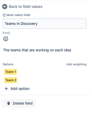

Huh. So then I noticed I can edit that field:
And after doing so, the option for the trigger showed deleted:
So after switching to "Teams in Discovery" I also had to change the smart value to {{issue.teams in discovery}} (it didn't seem to care about case) and it continued to return the expected values.

Oh! Looking at your screenshot:
The problem might be that you're doing this inside of a Lookup branch, in which case, you really need to be looking at:
{{lookupIssues.issue.Teams}}
Which (I THINK) will give you all of the Teams for all of the matching issues? Or you could probably more clearly list each issue with their teams with something like:
{{#lookupIssues.issue}}{{key}} - {{Teams}}{{^last}};{{/}}{{/}}

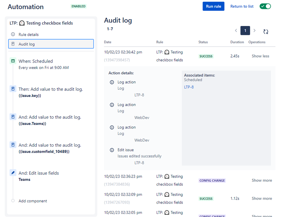

Brock Jolet
February 10, 2023

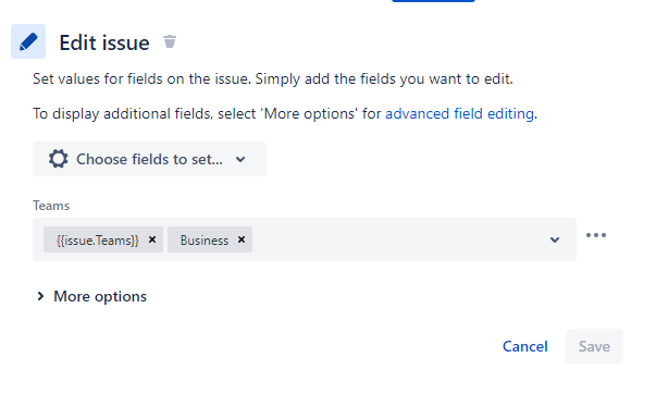

I feel silly, but you've helped me achieve my goal. My log wasn't showing any data because the field didn't have any data in it. The smart value was correct the whole time. Once I added some data, WebDev, it appeared in the logs.

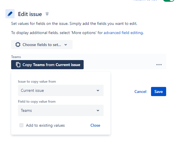

Here is what I was trying to do with that smart value. I wanted to retain the existing values while adding a new value depending on external interactions. The UI doesn't have an "Add to existing values" checkbox unless you copy the data from another field. I can confirm that this setup works as intended now.
Now to figure out how to subtract values without removing all values, but I think I've got a great launching point. Thanks for the help!
