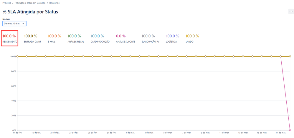

For a given workflow, I created an SLA for each status.
However, when I go to check the % of sla hit report, I only have a snapshot of the moment, not the history.
My report fluctuates between 100% or 0%.
Where is my mistake?

The report should also be able to show the history of the SLA met percentage.
It might be that the selected series has a limitation but we can't help you when we don't have all the information.

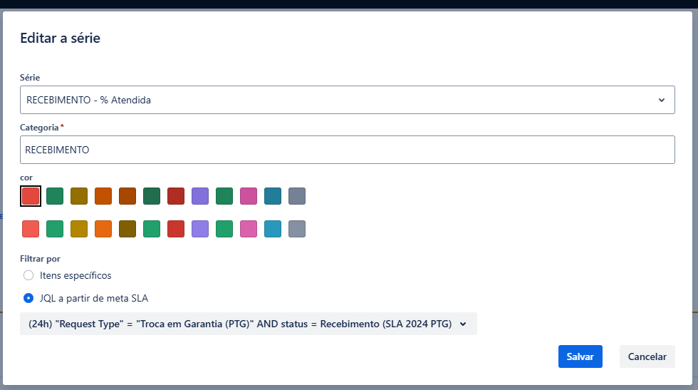

Could you provide us with a screenshot of your series configuration (JQL please) and a screenshot of your report? That way we should be able to offer a more helpful response.

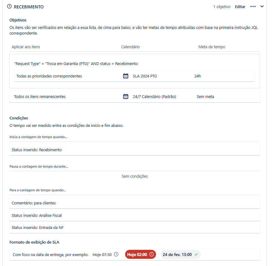

I think I see the issue and it has to do with you SLA configuration.
You are selecting issues that have a certain request type AND a certain status
You then set the SLA to start when the issue is transitioning into that status. This means that the issue is never targeted since it already has that status.
I would advice to reduce the issue selection to only the request type and try with that.
