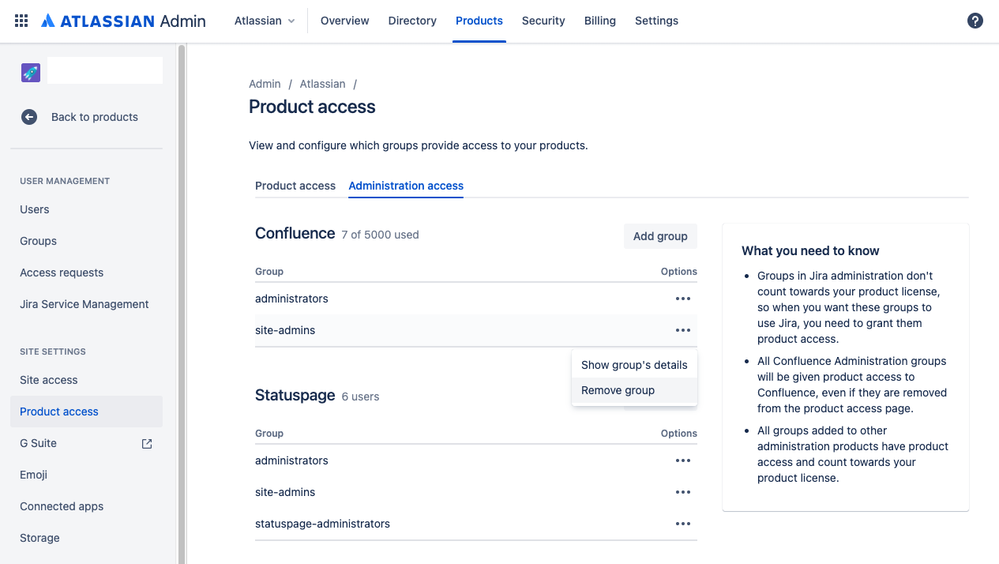

Angélica Luz
January 10, 2022
Hello @Petr AST,
Thank you for your question!
Although it’s been almost three years, the steps are still the same, but I just tested here and there is one more step.
Go to the Cog icon > User management > Product access > Administration access.
By default it will be administrators and site-admins, so you can remove the site-admins group from Confluence and any other product if necessary.

Petr AST
January 11, 2022
@Angélica Luz As always, thank you!)
I never thought that deleting from this page would help!
I appreciate your time, all the best!

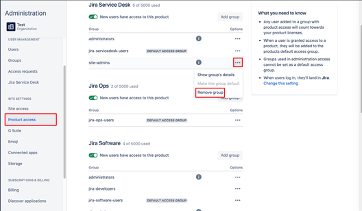

August 13, 2019
Hi George,
Thank you for reaching out to Atlassian Community!
Usually, the group site-admins are also added on the product access, so when a site-admin is added they also receive a license for the product.
To fix that, please, go to Administration > Product access and remove the group from Service Desk:
This configuration won't affect existing users, but for new users, when you add the group site-admins they won't receive the license, just the permission to be an admin.
After that, try removing the group jira-servicedesk-users from the profile of the affected user.
