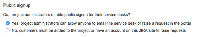

Vasileios Giannakopoulos April 27, 2018
Hi,
Thanks for your answer @Andy Heinzer but i had already done that.Screen Shot 2018-04-27 at 20.19.58.png
Maybe i am missing something else?
Thanks!

Andy Heinzer
April 27, 2018
In that case, I would recommend looking back at the documentation on Enabling public signup for JIRA Service Desk:
Since you have already enabled this for Service Desk in that screenshot, we then should check the specific project permissions for this particular Service Desk project:

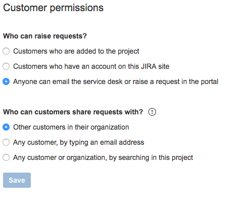

Now... By "Project administration" i guess you mean "Project Settings", the cogwheel in the project down left. In there, there is a Customer permissions
However, the option "Anyone can sign up for a customer account on my Customer Portal" is not there. I checked the Enabling public signup for JIRA Service Desk but i see the same issue:
Andy Heinzer
April 27, 2018
Yeah, I am aware this is a server version of Service Desk.   Thanks for checking this other setting as well.
Can you tell us more about your current User Directory settings in Jira?  Specifically I would like to know what your /plugins/servlet/embedded-crowd/directories/list page looks like.  You can also get to this by going to Cog -> User Management -> User Directories.
The scenario I envision at this point is that you have a 'read-only' directory in the top position.  As such Jira can't create new accounts in this read-only directory, like it could inside the Jira internal directory.
Of course I could be wrong, but given the error message I saw, there appears to be something on the system that prevents account creation right now.  If this is not the user directory settings, then we need to know more about this environment to better troubleshoot this problem.
