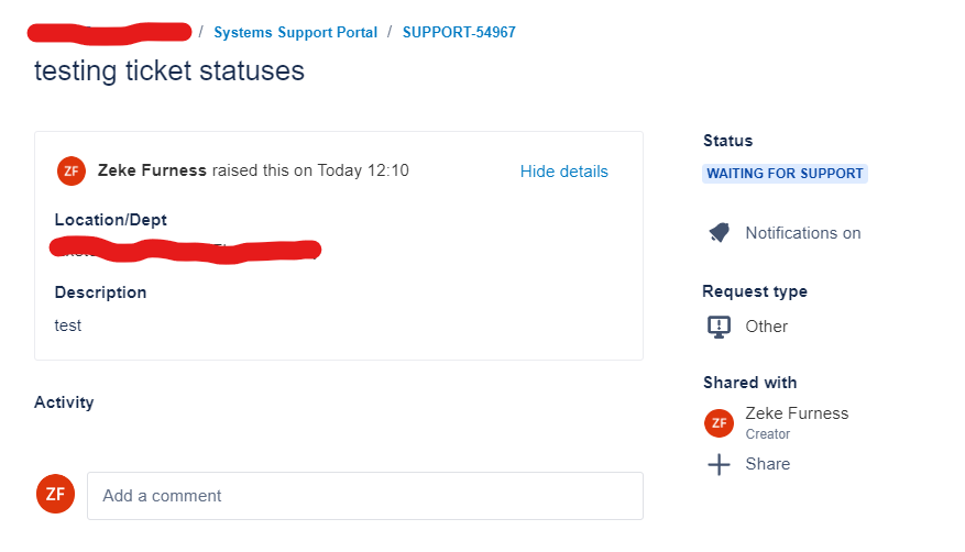

Not really sure how much info to go into without oversharing(!) but basically would like to know if you can get other fields to show in the ticket view for a customer that aren't editable by the customer.
Basically I want to use a dropdown that only we control with a list of comms statuses on the ticket "waiting for support, customer, 3rd party" etc.
At the moment we use the traditional statuses to show that but I'm about to implement some SLAs for triaging purposes (as SLAs appear to only be tied to traditional statuses.);
As such, I'm looking for another field to show customer's and agents who needs to respond to the ticket.
Has anyone figured this out?
Thanks in advance.

Hi Dirk,
Can the priority field be shown to the customer, without the field they can change the value of?
I just want customers to see what priority their ticket is and who it's currently waiting on.
Thanks
Zeke

Hmm @Zeke Furness ,
I do think (since it's a system field) that it's shown on their by default but if not you can always set it as a hidden field on your request type with a default value (always a good idea)
Once the ticket has been submitted they won't be able to change it
