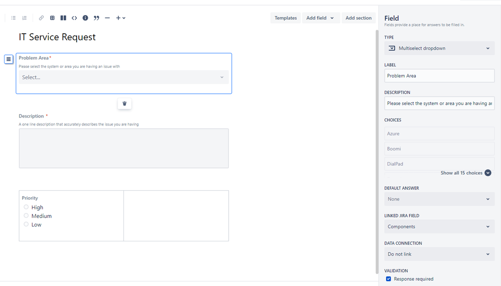

The main thing is to verify that the component is actually getting set on the issue.  That will confirm that the Form is properly linking to Jira.  If you don't have a component, the problem lies in the form configuration.  Please share a screenshot of your form's Problem Area field config if it's not working.
Charlie Buege
June 16, 2023
Here's the screenshot of the config.  You can see that the multiselect dropdown has 'Components' as the Linked Jira Field.  That's the only way I could get the components connected to a field in the form.  I don't understand why 'Dropdown' isn't available as an option for components, but if I chose that, the Jira linked field to components goes away.  I do only want a single component select, but I think I'm getting around it by setting my minimum and maximum number of choices to one each.Probelm Area Screen Shot.png

Correct - If you're going to link your form to component it adopts the field type and components are multi-select.  Nifty solution by setting the min/max number of options though!
