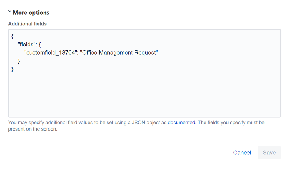

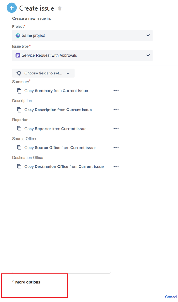

If you have Automation for Jira, you can set the customer request type quite easily at the create stage using the following example
{ "fields": { "customfield_13704": "Office Management Request" } }
If you are creating tickets internally within Jira and want to ensure the customer request type gets set, then just add the customer request type to the internal create screen and make it mandatory.

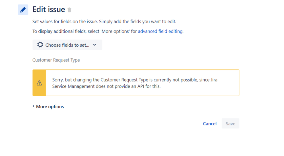

I am using Cloud Instance, i tried to using the if else automation but it throws erroCRT pic 2.PNG
