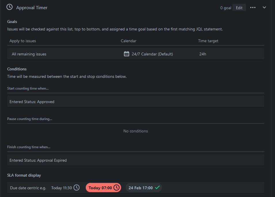

The easiest way to set this up is by making use of an SLA.
You can create an SLA that starts when an Issue enters the status Approved and set a goal of 24hours. Please make sure that you have selected the correct calendar for this, or adjust your time goals accordingly. Otherwise the 24hours will be three standard 8-hour working days.

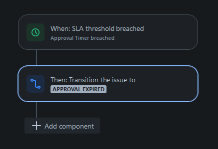

After you have created the SLA, you can create an automation that triggers on the expiry of the newly created SLA and transitions the issue to the status "Approval Expired".

Ann R
February 8, 2024
Hi @Paul Wiggers Thank you! i will give it a go.
Ann R
February 11, 2024
@Paul Wiggers - This worked. Appreciate your help with this.
