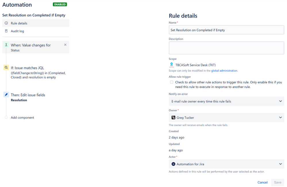

We have an integration that is changing the status of an Incident to Completed, but isn't setting the Resolution field. Resolution field is normally chosen in the Resolve Issue Screen. Unfortunately, not having a working Resolution is breaking some workflow, such as appearing in Queues that it shouldn't, and SLAs not ending correctly.

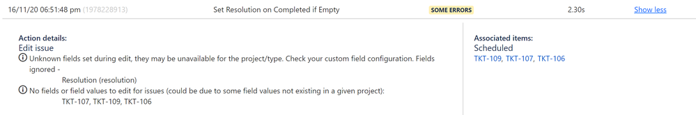

I created an Automation (new style) to set it, but it returns an error:
Here are details of the Automation. Any idea why I cannot set the field? I am guessing it's a permission issue with the Automation for Jira service (account?) but cannot find where it's defined.

Could you change your rule so that it changes the resolution when the issue transitions rather than after?  It may be that automation is unable to set the resolution once resolved.
You should also check you don't have another field called 'resolution' as it may be looking to amend the wrong one.

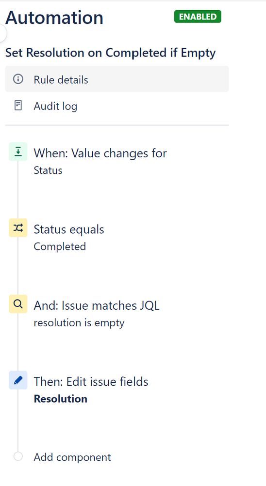

I have modified the automation to trigger on update of Status. But the automation is not firing. I tried it initially with drag and drop conditions, but there was no option for Resolution is empty (only an option for Unresolved) but it didn't fire. Should I try status in (Completed, Closed) instead of fieldChange?

I tried a couple variations like this but I still cannot get the rule to fire.

Liam Green
November 17, 2020
Hi
Can you try with the trigger of 'when issue is transitioned', then it will capture them going forward.
For ones that do not have a resolution that need one, you may need to do another rule that is manual trigger.

Greg Tucker
November 19, 2020
@Liam Green @Dirk Ronsmans The on transition version of the rule worked. Thank you.
