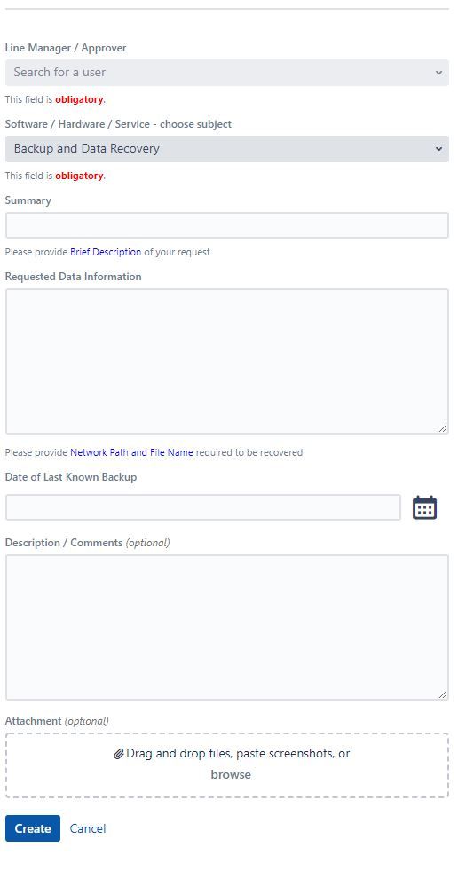

So for example if I use Data Backup Request i created - on the portal it looks good - it present all required fields. But then when i open ticket in Service Desk queue, in details view i can see values for fields from other requests (for example intended for Mailbox access).

- portal view1 - that shows request form with all required fields

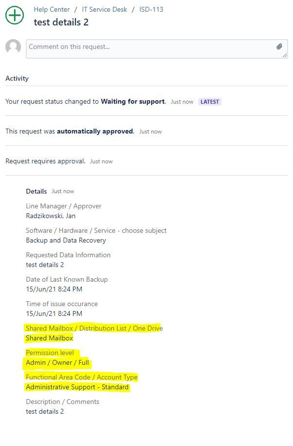

- portal view2 - that shows details presented to end user after creating ticket (details marked yellow are unintended for this request form and was not presented on above Request Creation form)

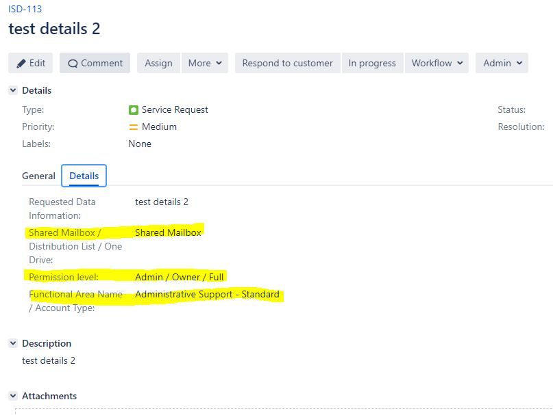

-sd ticket view1 -  showing Service Desk agent view of this ticket - again yellow are uninteded details for this request

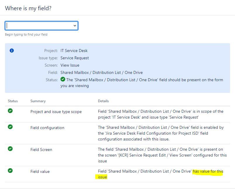

- admin "where is my field view" - showing some info about this additional fields.
Marked yellow is information that unintended field has a value for this issue - and i have no idea where this value comes from

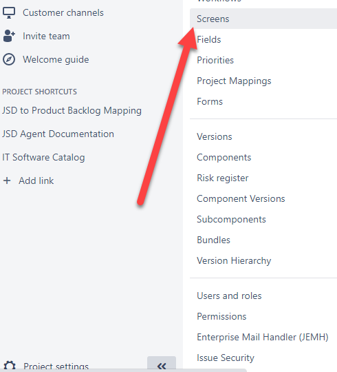

Welcome to the Community. You will need to adjust the issue type Screen Scheme associated to your Request Form's issue type (NOTE - this screen scheme is different than your setup for the Request Forms for the portal).   You can access the screen scheme via "Project settings"> Screens
Once in the Screens Scheme UI, access the screens associated with the appropriate issue type, then remove the fields as needed.  When you view the issues in the project UI (not protal UI), the screen is configured/controlled via the project's screen scheme configuration.  In Jira/JSM, there are three basic issue screen setup (CREATE ISSUE, EDIT ISSUE, and VIEW ISSUE).

After re-analyzed your original ask, you need to look at the field in question to see if it is setup with default value or not.  You will need to access Administration > Issues > Custom fields to find out if there is default value configured.  If so, you need to clear out the default value.
I am assuming that your Request Type Form (for the Portal UI) for the different types of request are using the same issue type, thus you cannot have default value setup in those fields.  In Jira/JSM, if a field has no value associated with it, then it will not be displayed in the ISSUE VIEW screen.
