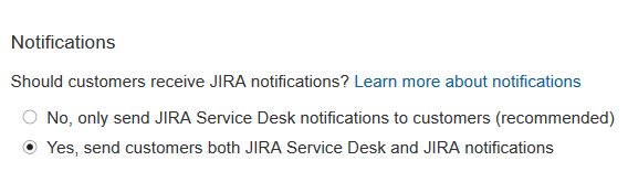

That does sound strange.  Only agents will be able to receive a notification from Jira (vs Customer notifications).   Are you an agent on that project?
There is another setting that might be useful, but you need to be careful with it.  Under Applications - Jira Service Desk configuration, there is this.  The default is "No", but you could try  Yes if trying to reach non-agents.

I just checked and yes, I was already added as an agent to the project. Also my account is assigned to the the service-desk group, so it is also associated with the license.
I tried enabling that setting and IT WORKED! It's kinda odd though, reading it's decription, it seems to only impact emails meant for costumers but I'm an Agent. Maybe it is because I am also a costumer?
Anyway, thank you very much! That was a great help.

Hi Susan,  I have been searching for this solution for 2 days.  So far this works.  Thank you so very much!!

We had the same problem and it worked as well. The same situation: I am also a customer.

I think the problem is that you are also customer. I have one project where I'm customer and agent and not receiving any mail. All other service desk projects (unique schemas) send me mails in agent role.
