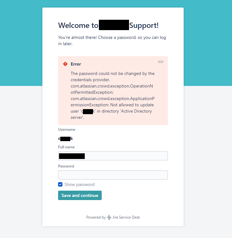

Some of our clients are set up in our AD in order to access Confluence.  When those same users try to set up Jira Service Management accounts, they are not able to set their passwords because they are recognized by Jira as AD users.
Is there a way to work around this?
Post a new question
Brant Schroeder
August 6, 2021
@Tamara Schacham The workaround would be to use a different email address or educate those users that they already have an account in JSD.  Unfortunately, once their account is created in the user directory you are using Jira will recognize it there and not allow them to create another account.

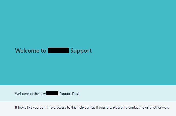

As it turns out when our AD users try to access JSD, they get the following error.
Do you have any other suggestions?
Brant Schroeder
November 17, 2021
Do these AD users have access as customers to the service desk or is your service desk available to everyone?  https://support.atlassian.com/jira-service-management-cloud/docs/change-project-customer-permissions/

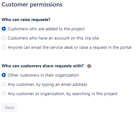

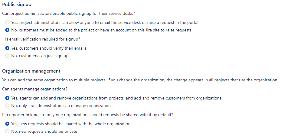

We have the following setup:
I'm thinking that we could change "Who can raise requests?" to "Customers who have an account on this site", but I'm worried about side effects.  We will still want to be able to add customers to the project who aren't in our AD by email invitation as we do now.
Also, I tried this change out on our test instance but found that neither the AD user nor the non-AD user that I added by invitation could see other tickets belonging to the organization unless it was explicitly shared with their Id.  I'm not sure if this is related to the configuration change.
