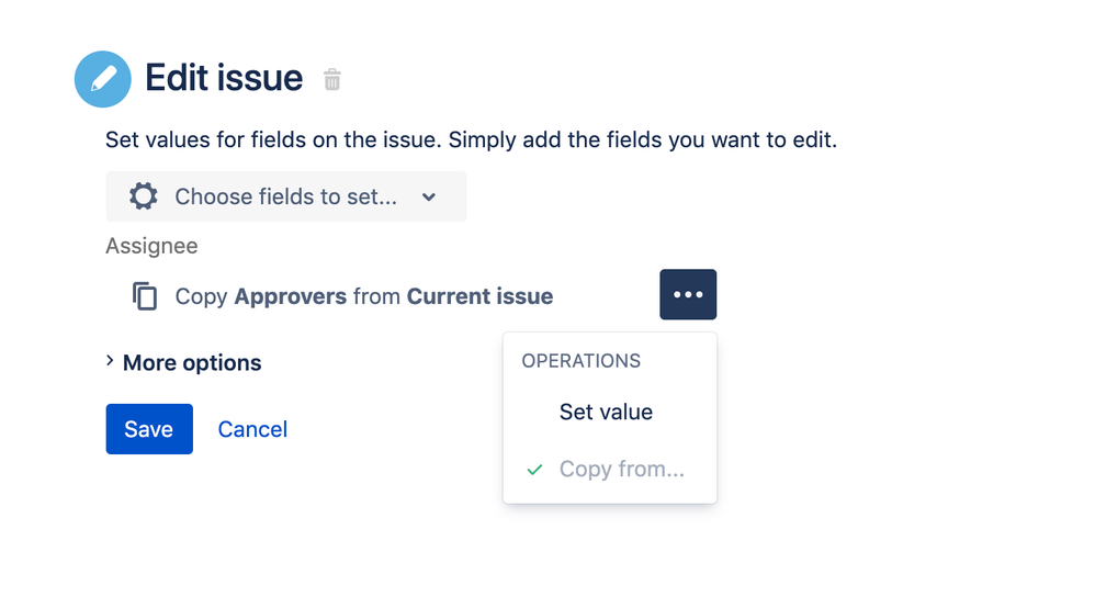

  3. Add a new action and use Edit Issue
  4. Select the Escalated By field and change it from Set Value to Copy From         (Below screenshot for example)
  5. Then change the field you are copying from to the Assignee field
  4. Select the Assignee field and change it from Set Value to Copy From
  5. Change the field it's copying from to the Escalated By Field. (screenshot for example)

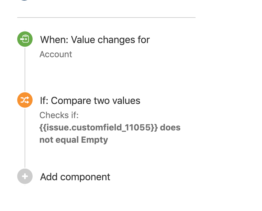

  1. Instead of using the trigger, Issue Transitioned you would use Field value changed
  2. You would select the field Support Tier
  3. Then add a compare condition
  4. For the first field, input {{issue.customfield_IDNUMBER}} replace IDNUMBER with the custom field ID
    You can get this ID by going to the custom fields section in Jira Settings < Issues < Custom Fields
    Find the custom field and select Edit
    The ID will be at the end of the URL
  5. Once you have the ID and the first part filled out, set the condition to Does not equal
  6. Leave the second value empty.
  7. Continue with steps 3-7 in automation 1

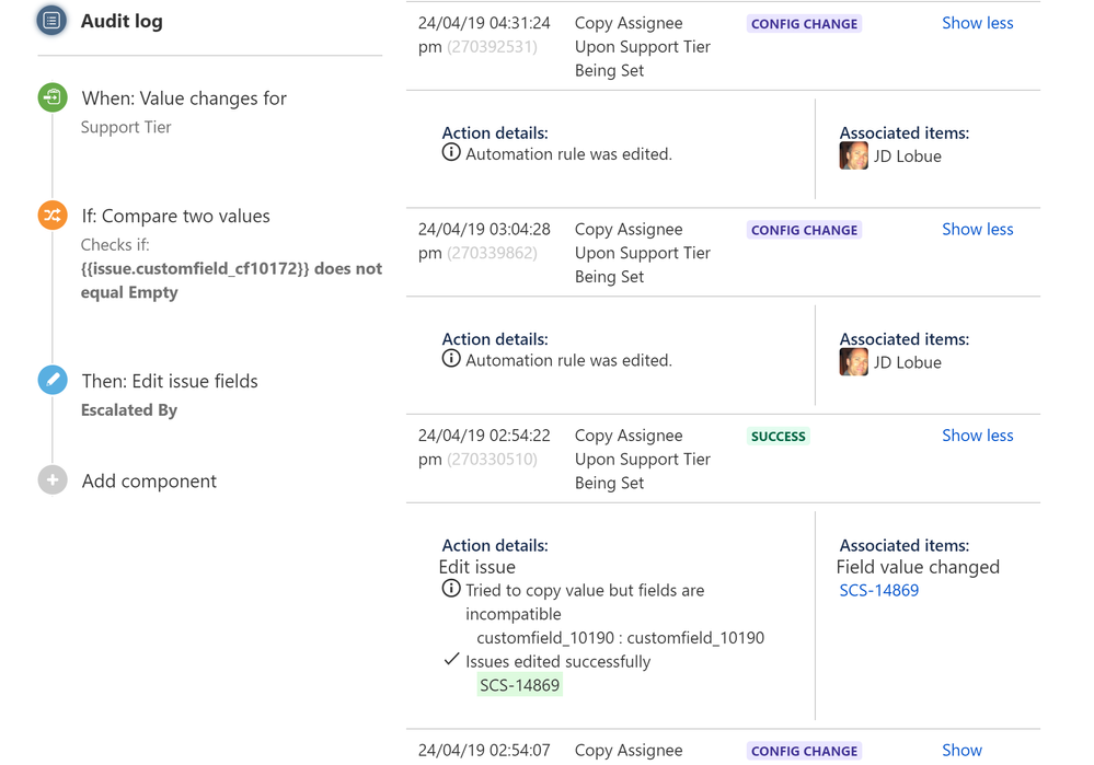

This is what I got in the log for the rule:
Action details:
Edit issue
Tried to copy value but fields are incompatible
customfield_10190 : customfield_10190
Issues edited successfully
Any ideas? The custom field is a user picker for all issue types. I don't have it available on any screens because I want it hidden. Do I need to configure the custom field in any way for compatibilities sake?

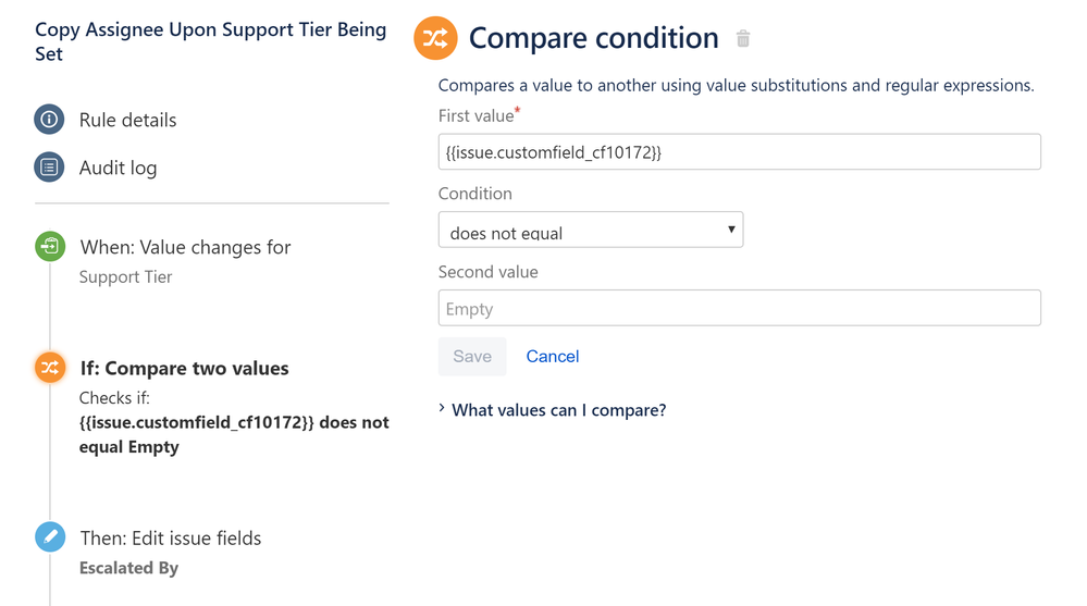

Cody Stevens
April 24, 2019
The if condition is a failsafe so the automation doesn't accidentally run. I recommend keeping it.
From the error you provided, it looks like the field may have been inputted incorrectly. Do you have it in the below format?
{{issue.customfield_10190}}
If not please change it to that, if you do can you please take a screenshot of the if condition and the audit log?
JD Lobue
April 24, 2019
JD Lobue
April 24, 2019
Cody Stevens
April 24, 2019
Ah, that's your problem! It needs to be exactly {{issue.customfield_10190}}. You have the cf before the number.
JD Lobue
April 24, 2019
I found the error. I had the value pulling from escalated by and not from assignee. Thanks for all your help. What if I want to allow the support tier to be able to move from one escalation dept. to another? Can I change the condition to allow for that?

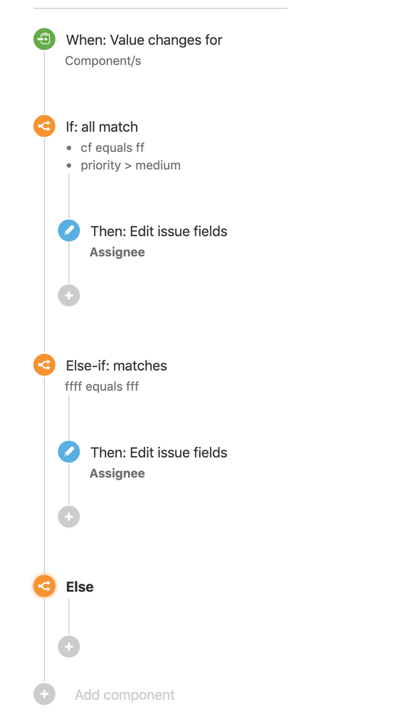

It can do pretty much anything you can imagine. To achieve that you would use the condition If else Block. You would add the conditions and actions under the first block and you would add a jql saying Support Tier = Tier 1 or a compare condition for {{issue.customfield_10190}} equals Tier 1.
Then add and else and do the same stuff but change the Tier 1 to Tier 2 and then change who the assignee is.
