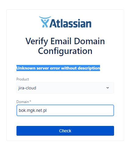

Hello, I did everything that is written on the page: https://confluence.atlassian.com/adminjiracloud/configuring-jira-cloud-to-send-emails-on-behalf-of-your-domain-979428371.html
on mxtool I see the correct configuration ...
but at https://domain-check.atlassian.com/ I keep jumping out:
Unknown server error without description

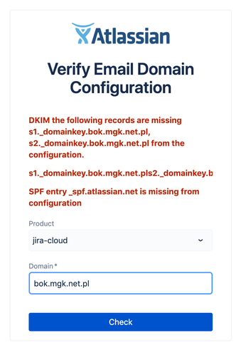

Hazwan Ariffin
March 29, 2020
Try again or try on a different browser, you'll get the error
Running dig, indeed the records are missing:
dig -t TXT bok.mgk.net.pl
; <<>> DiG 9.10.6 <<>> -t TXT bok.mgk.net.pl
;; global options: +cmd
;; Got answer:
;; ->>HEADER<<- opcode: QUERY, status: NOERROR, id: 54364
;; flags: qr rd ra; QUERY: 1, ANSWER: 2, AUTHORITY: 0, ADDITIONAL: 1
;; OPT PSEUDOSECTION:
; EDNS: version: 0, flags:; udp: 512
;; QUESTION SECTION:
;bok.mgk.net.pl. IN TXT
;; ANSWER SECTION:
bok.mgk.net.pl. 300 IN CNAME mgknetpl.freshdesk.com.
mgknetpl.freshdesk.com. 300 IN TXT "v=spf1 include:sendgrid.net include:mailgun.org ~all"
;; Query time: 640 msec
;; SERVER: 192.168.0.1#53(192.168.0.1)
;; WHEN: Mon Mar 30 07:23:51 +08 2020
;; MSG SIZE  rcvd: 144
Or you can use the online SPF checker such as https://mxtoolbox.com/spf.aspx to check to confirm. Have the record added to your domain's SPF records and DKIM record to your domain's DKIM records.
