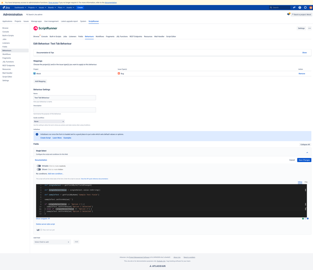

Below is the working sample code that I have tested with:-
def singleSelect = getFieldById(fieldChanged)
def singleSelectValue = singleSelect.value.toString()
def sampleText = getFieldByName('Sample Text Field')
sampleText.setFormValue('')
if (singleSelectValue == 'Option 1') {
sampleText.setFormValue('Option 1 Selected')
} else if (singleSelectValue == 'Option 2') {
sampleText.setFormValue('Option 2 Selected')
Please note that the sample working code above is not 100% exact to your environment. Hence, you will need to make the required modifications.
In this test case, the Single Select List "Single Select" is added to the first tab. If either Option 1 or Option 2 is selected from the Single Select List, the text field, i.e. Sample Text Field which is set on the 2nd tab will update accordingly.

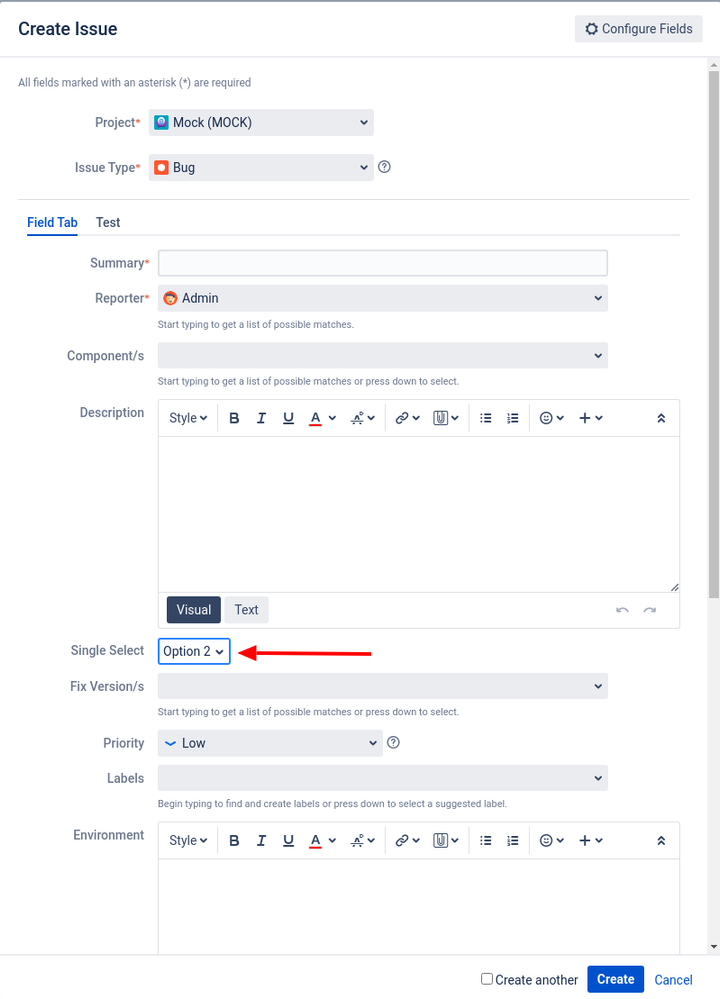

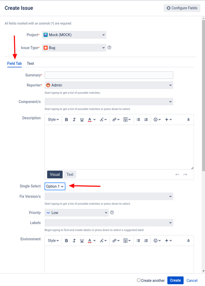

1) The Single Select List is added to the first tab, i.e. Field Tab as shown in the screenshot below:-
2) When Option 1 is selected from the Single Select List on the first tab as shown below:-

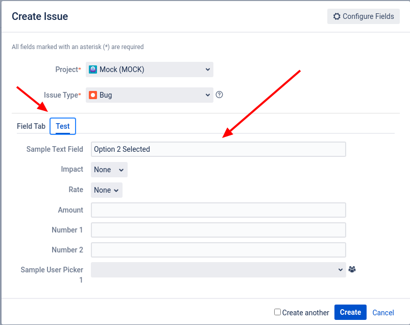

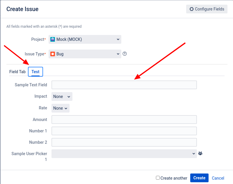

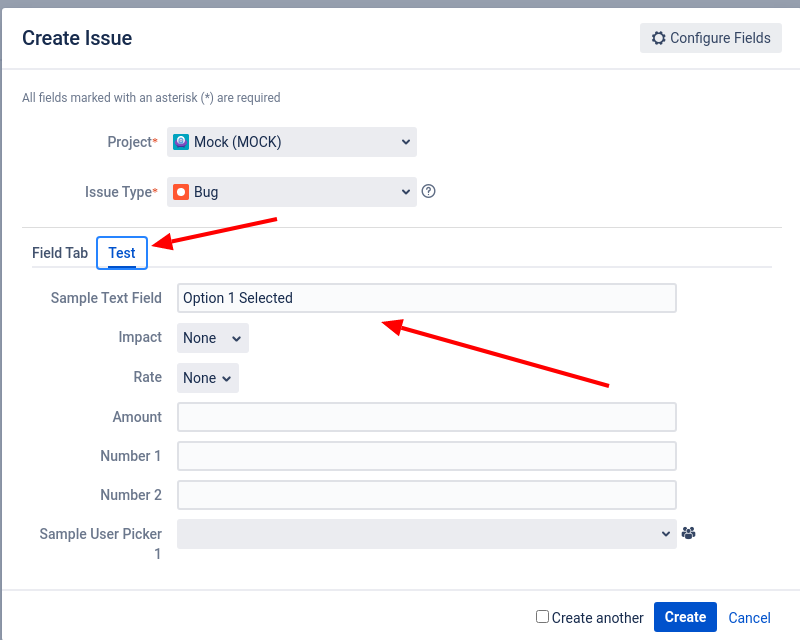

3) As expected the text field Sample Text Field is updated to "Option 1 Selected" on the second tab as shown below:-
4) When Option 2 is selected from the Single Select List on the first tab as shown below:-
5) As expected the text field Sample Text Field is updated to "Option 2 Selected" on the second tab as shown below:-

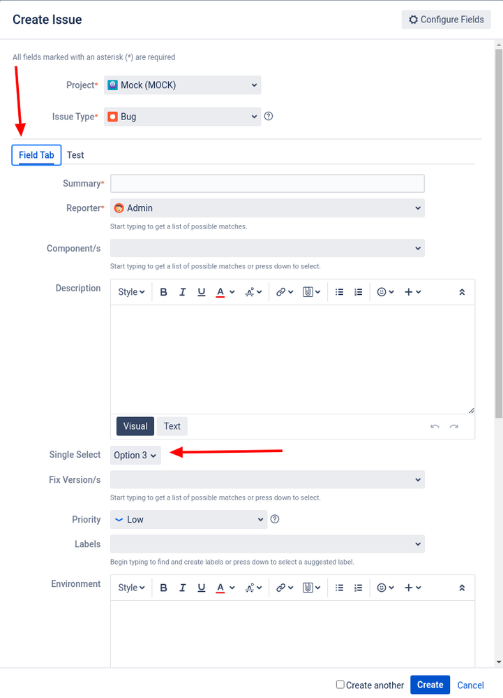

6) When Option 3 is selected from the Single Select List on the first tab as shown below:-
7) As expected the text field Sample Text Field is cleared on the second tab as shown below:-

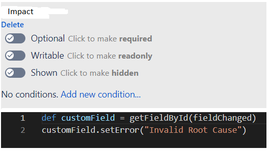

Instead of your script above, can you try adding any second tab field as a field and then try to add some error whenever it changes. Select Impact field and then add server side script.second_tab_field.PNG

Looking at the code you have shown in your screenshot, you seem to be setting the error message on the Server-Side Behaviour with no condition to determine when the error message should be displayed. I suspect this is the main problem.
Please refer to the sample code I provided and observe how I have added the if/else condition to determine when the error message should be displayed.

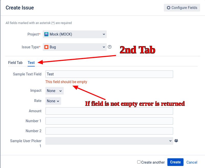

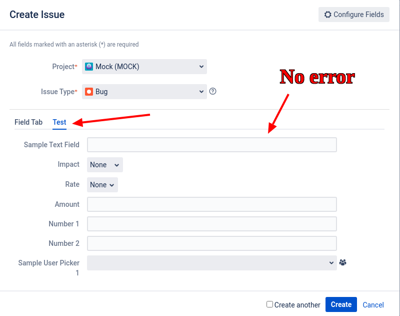

Below are a couple of test screenshots:-
1) If the Sample Text Field has any value, the field's error message is displayed as shown below:-
2) If the field is empty, the error message is also removed as shown below:-
