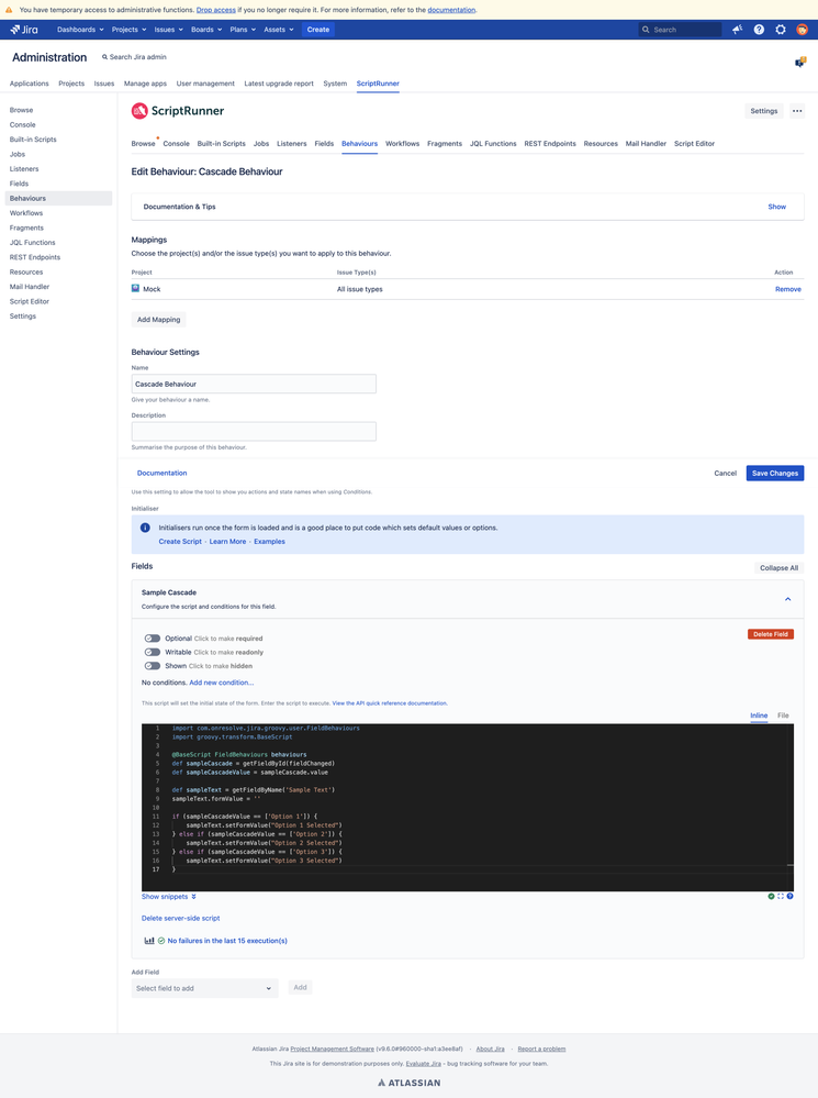

Below is a screenshot of the Server-Side Behaviour configuration:-

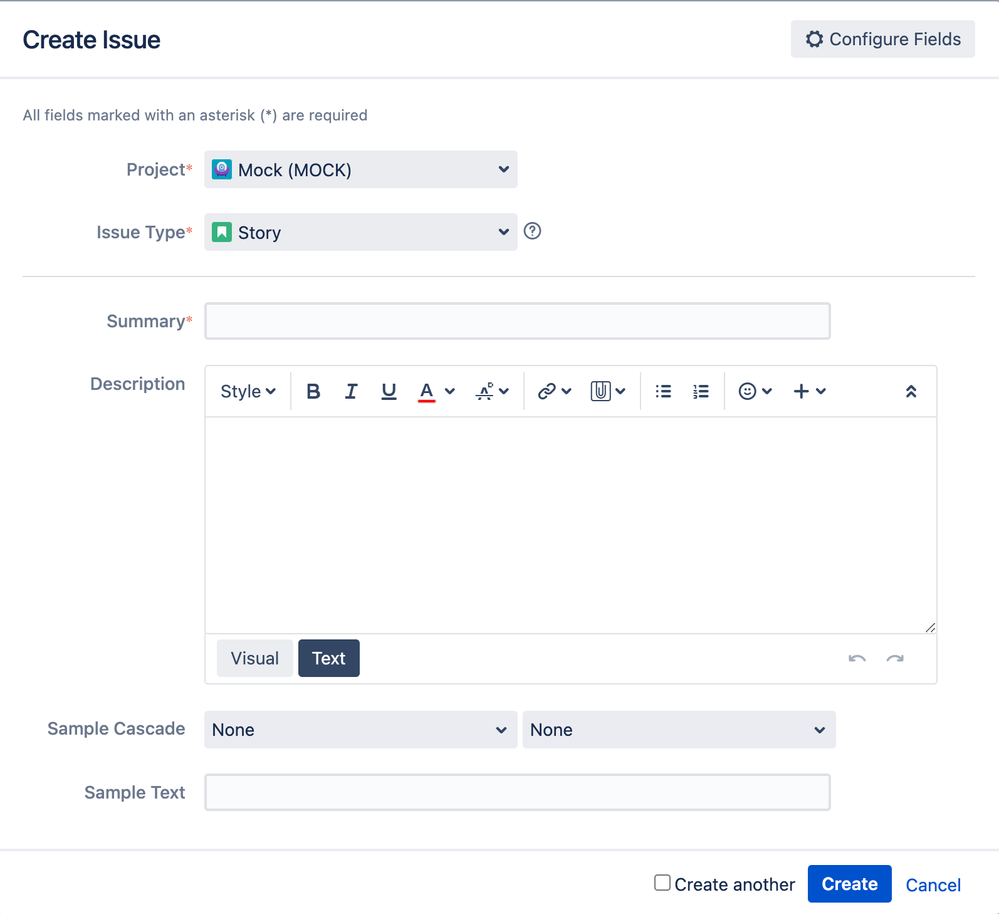

1. When the Create Issue dialog first loads, no option from the Cascading List is selected. Hence, as expected, the Sample Text Field is not updated either.

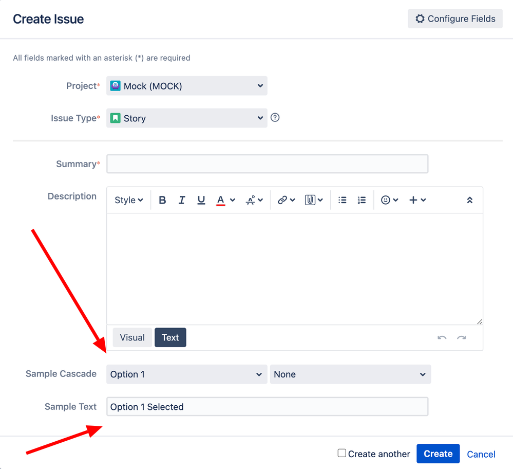

test1.png2. If Option 1 is selected from the Parent option of the Cascading Select List, the value in the Text Field is set to Option 1 Selected, as shown below.test2.png

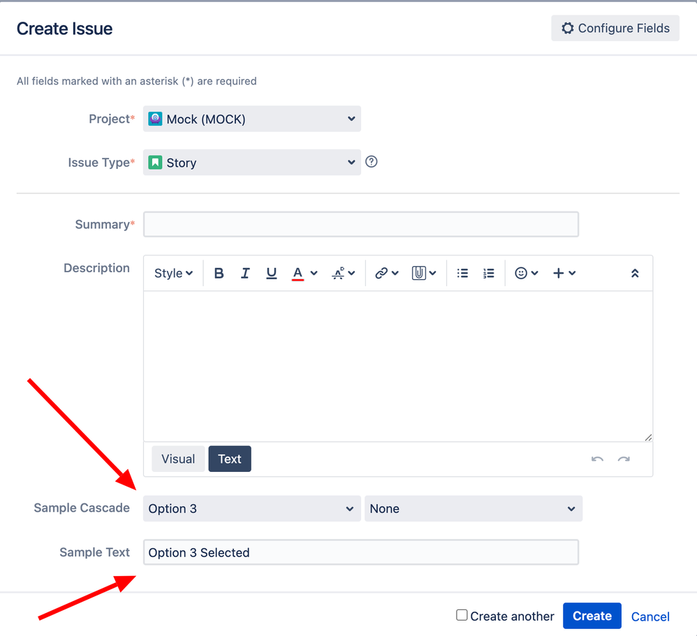

4. If Option 1 is selected from the Parent option of the Cascading Select List, the value in the Text Field is set to Option 3 Selected, as shown below.test4.png
