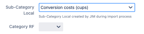

What happens is upon selecting an option in Field A, Field B changes from "None" to just nothing. If you click the drop down menu, the desired option is the only one available. Here is my code:

Here are screen shots of what is displayed after making the selection.

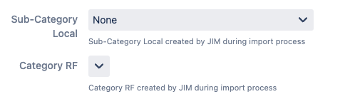

I've been playing with an ending "else" that sets the Category RF field to "None", and that seems to be "fixing" the problem. However, the Category RF looks like this when the Create form loads. That's better, but not idea.

So I have added the following at the end of my script, and it allows the Category RF to show the default "None" option.

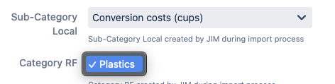

So it turns out it could have been partly the version I had on my server, 6.26, and partly been how I was setting it. Here's what I should have been doing:
if(subCategory == "Conversion costs (cups)")
categoryRF.setFormValue('Plastics')
