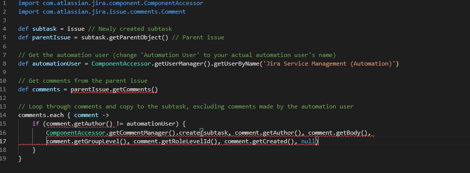

I got an script but its showing error. Can some one help me with the correct script.
 import com.atlassian.jira.component.ComponentAccessor
import com.atlassian.jira.issue.comments.Comment
def subtask = issue // Newly created subtask
def parentIssue = subtask.getParentObject() // Parent issue
// Get the automation user (change 'Automation User' to your actual automation user's name)
def automationUser = ComponentAccessor.getUserManager().getUserByName('Automation User')
// Get comments from the parent issue
def comments = parentIssue.getComments()
// Loop through comments and copy to the subtask, excluding comments made by the automation user
comments.each { comment ->
if (comment.getAuthor() != automationUser) {
ComponentAccessor.getCommentManager().create(subtask, comment.getAuthor(), comment.getBody(), comment.getGroupLevel(), comment.getRoleLevelId(), comment.getCreated(), null)

@Ram Kumar Aravindakshan _Adaptavist_ I am getting errors as in the attached screenshot. I can add it to the post function just looking for correct one.sceensh.PNG

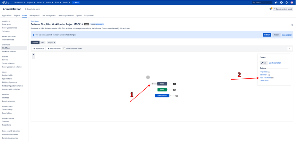

For your requirement, I suggest creating a Post-Function in the Create transition.
Below are the steps for your reference:-

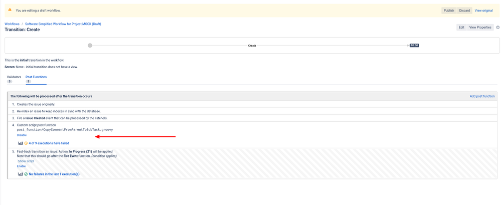

1. Go to the Create transition and add a Post-Function as shown in the screenshot below:-

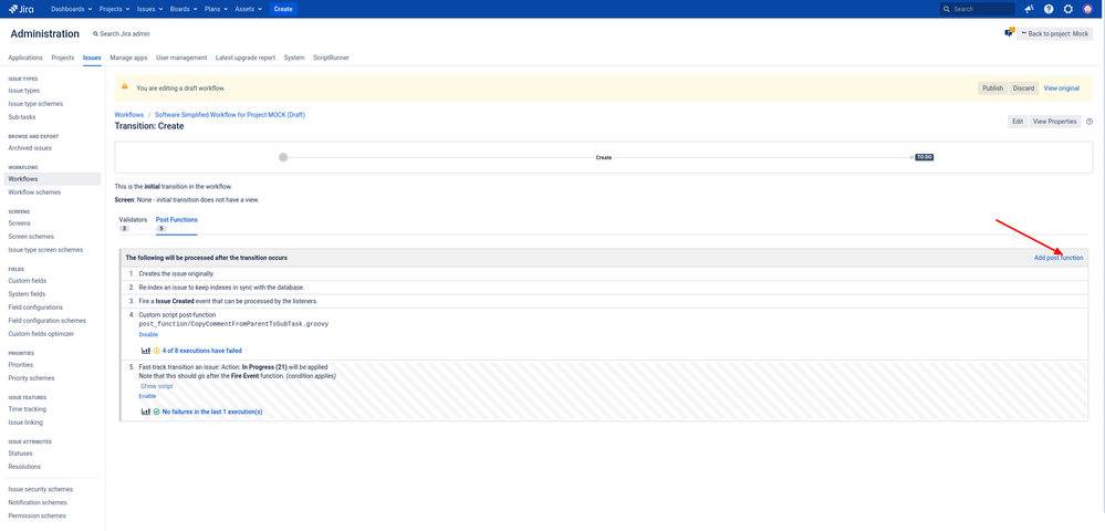

2. Add a Post-Function as shown below:-

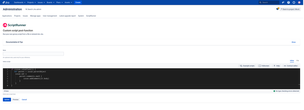

3. Select ScriptRunner's Custom Script Post-Function, as shown in the screenshot below:-configuration3.png
Once you are on the Custom Script Post-Function page, add the sample code below:-
if (issue.isSubTask()) {
def parent = issue.parentObject
issue.set {
parent.comments.each {
issue.addComment(it.body)
Please note that the sample code above is not 100% exact to your environment. Hence, you will need to make the required modifications.
Below is a screenshot of the Custom Script Post-Function configuration:-
Save and Publish the Post-Function.

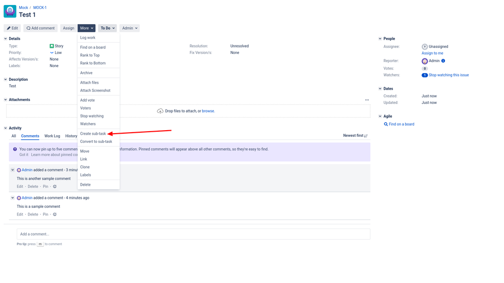

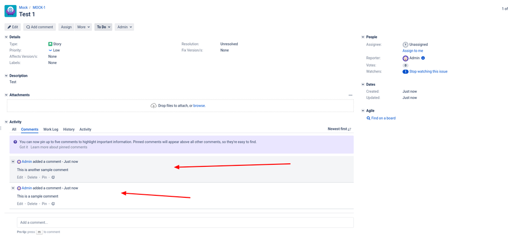

1. Below is an example Story issue with some comments added to it.
2. A Sub-task is added to the issue as shown in the screenshot below:-

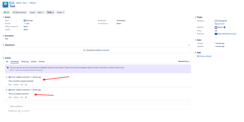

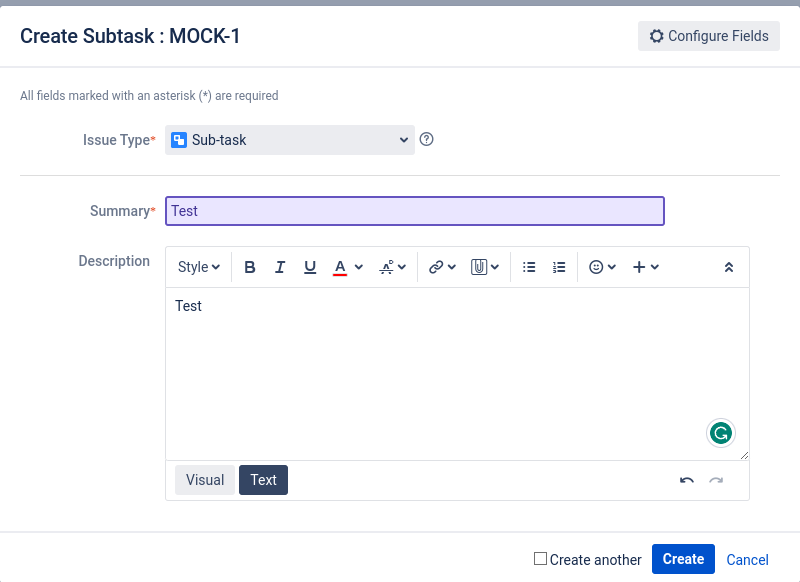

3. Add some details for the Sub-task on the Create screen and click the Create button as shown in the screenshot below.
4. Once the Sub-task is created, view it, and you will see that the comments, from the parent issue, have been copied as shown in the screenshot below:-
