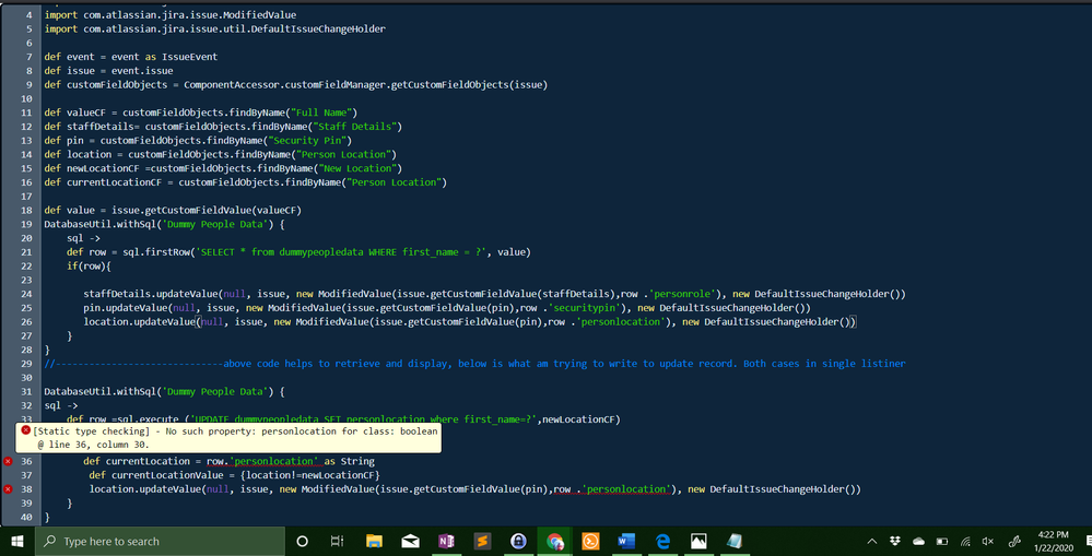

Thanks again, I can retrieve and display DB data into fields. by using a behavior & a listener
Am trying to use field behavior & listener to update column called 'person location' but couldn't figure how to get value from an input
Eg:
Location: street1
New Location: street15
By inputting name in the JIRA field, I can retrieve location in a JIRA field called 'Location'.
I can't figure out how to update the location record.
Usecase:
I want to update Lili's location from st1 to st15. If a new location is entered in Jira field called 'New Location, then I would like to update the personlocation record of Lili in db.
Here is the listener I'm using:
def valueCF = customFieldObjects.findByName("Full Name")
def staffDetails= customFieldObjects.findByName("Staff Details")
def pin = customFieldObjects.findByName("Security Pin")
def location = customFieldObjects.findByName("Person Location")
def newLocationCF =customFieldObjects.findByName("New Location")
def currentLocationCF = customFieldObjects.findByName("Person Location")
def value = issue.getCustomFieldValue(valueCF)
DatabaseUtil.withSql('Dummy People Data') {
sql ->
def row = sql.firstRow('SELECT * from dummypeopledata WHERE first_name = ?', value)
if(row){
staffDetails.updateValue(null, issue, new ModifiedValue(issue.getCustomFieldValue(staffDetails),row .'personrole'), new DefaultIssueChangeHolder())
pin.updateValue(null, issue, new ModifiedValue(issue.getCustomFieldValue(pin),row .'securitypin'), new DefaultIssueChangeHolder())
location.updateValue(null, issue, new ModifiedValue(issue.getCustomFieldValue(pin),row .'personlocation'), new DefaultIssueChangeHolder())
above code helps to retrieve and display, below is what am trying to write to update record. Both cases in single listiner
sql ->
def row =sql.execute ('UPDATE dummypeopledata SET personlocation where first_name=?',newLocationCF)
if(row)
def currentLocation = row.'personlocation' as String
def currentLocationValue = {location!=newLocationCF}
Attached is a code screenshot.
Please take a look if time permits and suggestUntitled.png.
Thank you

The problem might be that def row = sql.firstRow is inside the first withSql block.
Try it like this:
def row
DatabaseUtil.withSql('Dummy People Data') {sql ->
  if(row){
row.'personlocation' //this is now available ourside the sql block
This way, when you access row.'personlocation' in the next block the row object will be available.
Also, I see in the update block that you are using the customfield object newLocationCF instead of getting the actual value for the custom field: issue.getCustomFieldValuda(newLocationCF)
A small warning, using customFieldObject.updateValue() is not generally recommended. It's usually better to use issueService.validateUpdate() and issueService.update().
This ensures that permissions, audit trail and events are all correctly generated and managed.

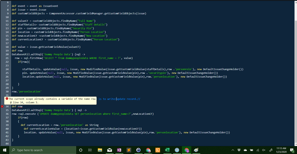

I have updated script per your suggestion, and I'm stuck with def row being
The script could not be compiled:
org.codehaus.groovy.control.MultipleCompilationErrorsException: startup failed:
Script111.groovy: 34: The current scope already contains a variable of the name row
 @ line 34, column 5.
   def row
1 error

Am trying to get a workaround, but ran out of ideas.  Please try to care to suggest.
PD Sheehan
January 23, 2020
Just as the error implies, you can't have "def row " twice.
Here is your full script, corrected as best as I could:

I've adjusted several of the variables to make it clear what they were. You seemed to have some mismatched between the fields you were trying to update and the value used in the modifiedValue object.
Also, I like to keep a minimal number of statements in the withSql block so that the sql connection can be closed as soon as possible.
And finally, execute doesn't return rows (just true/false). So I changed it to executeUpdate which returns a rowCount.

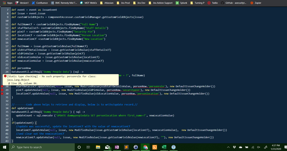

In if(personRow)
I see an error as follows and as attached
No such property: personrole : class java.lang.object
No such property: securitypin :class java.lang.object
No such property: personlocation :class java.lang.object
if(personRow){
staffDetailsCf.updateValue(null, issue, new ModifiedValue(oldStaffDetailsValue, personRow.'personrole'), new DefaultIssueChangeHolder())
pinCf.updateValue(null, issue, new ModifiedValue(oldPinValue, personRow.'securitypin'), new DefaultIssueChangeHolder())
locationCf.updateValue(null, issue, new ModifiedValue(oldLocationValue, personRow.'personlocation'), new DefaultIssueChangeHolder())
2020-01-23 16:34:00,537 WARN [sql.Sql]: Failed to execute: UPDATE dummypeopledata SET personlocation where first_name=? because: ERROR: syntax error at or near "where" Position: 43 2020-01-23 16:34:00,542 ERROR [runner.AbstractScriptListener]: ************************************************************************************* 2020-01-23 16:34:00,542 ERROR [runner.AbstractScriptListener]: Script function failed on event: com.atlassian.jira.event.issue.IssueEvent, file: null org.postgresql.util.PSQLException: ERROR: syntax error at or near "where" Position: 43 at org.postgresql.core.v3.QueryExecutorImpl.receiveErrorResponse(QueryExecutorImpl.java:2468) at org.postgresql.core.v3.QueryExecutorImpl.processResults(QueryExecutorImpl.java:2211) at org.postgresql.core.v3.QueryExecutorImpl.execute(QueryExecutorImpl.java:309) at org.postgresql.jdbc.PgStatement.executeInternal(PgStatement.java:446) at org.postgresql.jdbc.PgStatement.execute(PgStatement.java:370) at org.postgresql.jdbc.PgPreparedStatement.executeWithFlags(PgPreparedStatement.java:149) at org.postgresql.jdbc.PgPreparedStatement.execute(PgPreparedStatement.java:138) at com.zaxxer.hikari.pool.ProxyPreparedStatement.execute(ProxyPreparedStatement.java:44) at com.zaxxer.hikari.pool.HikariProxyPreparedStatement.execute(HikariProxyPreparedStatement.java) at Script28$_run_closure2.doCall(Script28.groovy:36) at com.onresolve.scriptrunner.db.AbstractDbConnectionManager.withSql(AbstractDbConnectionManager.groovy:63) at com.onresolve.scriptrunner.db.AbstractDbConnectionManager$withSql$0.callCurrent(Unknown Source) at com.onresolve.scriptrunner.db.AbstractDbConnectionManager$withSql$0.callCurrent(Unknown Source) at com.onresolve.scriptrunner.db.AbstractDbConnectionManager.withSqlTracked(AbstractDbConnectionManager.groovy:92) at com.onresolve.scriptrunner.db.DbConnectionManager$withSqlTracked.call(Unknown Source) at com.onresolve.scriptrunner.db.DbConnectionManager$withSqlTracked.call(Unknown Source) at com.onresolve.scriptrunner.db.DatabaseUtil.withSql(DatabaseUtil.groovy:22) at com.onresolve.scriptrunner.db.DatabaseUtil$withSql.call(Unknown Source) at Script28.run(Script28.groovy:35)
 However, even after those red errors, the listener gets updated  & saved. data retrieve works as expected, but listener logs error at sqlexecuteupdate. Error as above.
PD Sheehan
January 23, 2020
That is normal and expected.
The syntax checker is just a warning that something "might" be wrong. But it can't know what are the possible columns from the GroovyRowResult.
A different, but functionally equivalent syntax to get a column value is to use personRow['column name'] and that will pass the static type checker.
staffDetailsCf.updateValue(null, issue, new ModifiedValue(oldStaffDetailsValue, personRow['personrole']), new DefaultIssueChangeHolder())
pinCf.updateValue(null, issue, new ModifiedValue(oldPinValue, personRow['securitypin']), new DefaultIssueChangeHolder())
locationCf.updateValue(null, issue, new ModifiedValue(oldLocationValue, personRow['personlocation']), new DefaultIssueChangeHolder())

Well I think the problem is with your sql statement itself.
 updateCount = sql.executeUpdate ('UPDATE dummypeopledata SET personlocation where first_name=?', newLocationValue)
You won't find a row with first_name=newLocationValue. ANd you are not actually specifying anywhere what value to set on the personlocation field (missing personlocation=xxx)
Do you have a full name column? I see you are matching first_name db column to fullName value from jira.
But if you want to make an update you have to specify a value. And to send more than one value to a sql statement, the following syntax is better (using named parameters instead of ordinal parameters)
 updateCount = sql.executeUpdate ('UPDATE dummypeopledata SET personlocation=:jiraNewLocation where first_name=:jiraFullName', [jiraNewLocation:newLocationValue, jiraFullname: fullName])

So, what am I currently trying  vs what I get
  1. I have a Jira custom field - Full Name
  2. In Full Name- I'm inputting first_name value
  3. Based on first_name value, the listener is populating following fields
    1. personrole to Person Role(JIRA field)
    2. security pin to Security Pin(JIRA field)
    3. personlocation to Person Location(JIRA field)
  4. This data retrieval is working fine
  5. Now when Person Location is populated with personlocation(db value), I will check if first_name is still at personlocation or not.
  6. if not, then I want to populate New Location(JIRA field) with new personlocation, and update it in db
  7. similarly with securitypin, if a new pin is generated, I want to update db or let db create a new 9 digit and populate in New Security Pin(Jira field). This is something fancy
  8. I also have a field behavior on Full Name, whenever I input a first_name in Full Name, the behavior will check if first_name exists or not in db, if not an error message is displayed.
FYI- I'm using Full Name jira field to input just first_name.
I will try your suggested method and update shortly.
