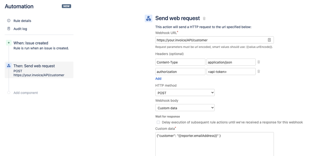

I'd be inclined to try and solve this using Automation for Jira, which is an Atlassian-owned app that runs on your local Server instance. You can play around with the rules and see what actions are available even before installing by heading over to the rule playground .
Depending on your invoice system's API, this could be as simple as one API call. Here's a potential example of firing a webhook when an issue is created:
Smart values in Automation for Jira allow you to access information from the triggering issue - like the reporter's name or email address. There are also smart values for webhook responses, so you could chain actions together based on what the responses from your inventory system's API look like.
These rules execute and process on your local Jira server, so that should alleviate concerns about involving a third-party or external system.

Certainly! Tick the "Delay execution of subsequent rule actions" checkbox in the Send Web Request action. This will give you some help text about how to access the response from the webhook:
HOW DO I ACCESS WEBHOOK RESPONSE VALUES IN SUBSEQUENT RULE ACTIONS?
On successful webhook execution, you would be able access webhook response data using the following smart values:
  • {{webhookResponse.status}} returns the response code e.g. 200
  • {{webhookResponse.headers}} returns the response headers that you can access using dot notation e.g. {{webhookResponse.headers.Content-Type}}
  • {{webhookResponse.body}} returns the response body, if the body is a JSON object then you can access values using dot notation e.g. {{webhookResponse.body.name}}
  • {{webhookResponses}} returns a list of responses e.g. {{webhookResponses.last.body}}
Then you can add an if / else block condition to compare the webhook responses to the values you want, and take further actions inside the blocks. The additional actions in the blocks can be more "Send web request" actions!
