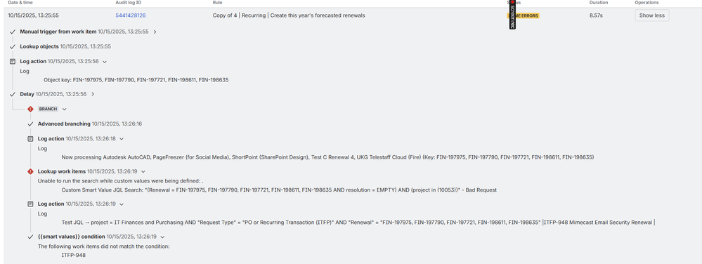

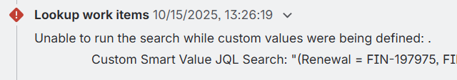

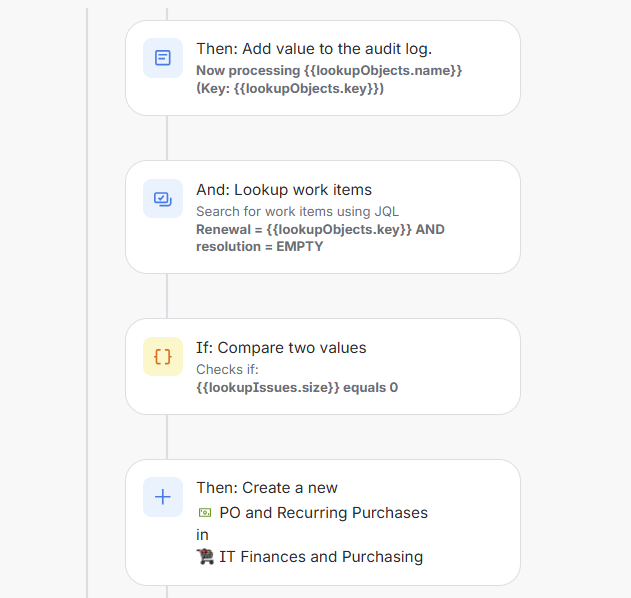

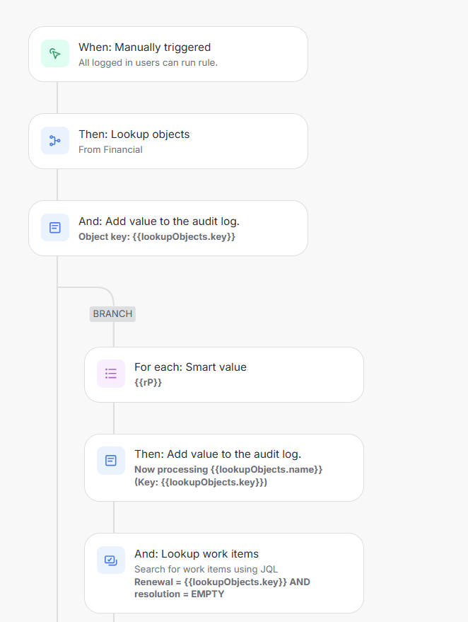

Various versions of the AQL search (branch and look-up objects), then lookup work issues, then compare lookup size. But the scope is not right/too big and I'm getting an "unable to run the search while custom values were being defined" error. Error and current testing iteration (with manual trigger) in screenshots. I get the same error if I schedule the automation or manual trigger.

What are the details of the branch step in your rule, are you processing each found object?
What i seem to miss is the work item lookup, what is the purpose of finding existing issues?
Also this JQL is failing, as it states that the field Renewal should be of type Assets, but this is not possible, you can't JQL on object key.
