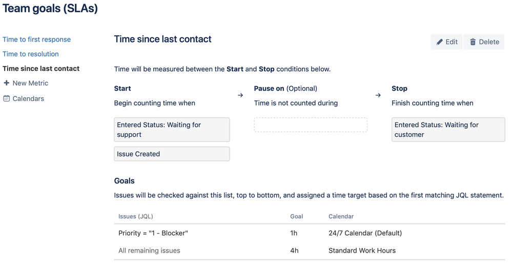

I've set up an SLA to measure time since a Support Engineer last contacted a customer. (For the purposes of development, I've specified 1 hour on Priority 1 issues and 4 hours on other issues.) See below:
Screen Shot 2019-04-23 at 4.04.22 PM.pngI tested by leaving a non-priority-1 issue uncommented for 4 hours. The SLA breach was triggered.
The SLA breach was NOT reset when I posted a customer-facing comment in the portal. However, the SLA breach WAS reset when the customer added a comment to the issue.
Am I making an obvious error here?

Please, allow me to bring up what I have noticed on the information you provided so we can confirm we are on the same page:
I noticed that the SLA  is configured to only stop once the issues are transitioned to the status Waiting for Customer.
Considering this fact, comments should not STOP the SLA, unless you have any automation rules that would transition the issues when a comment is added. I believe you might have an automation rule that might be transitioning the issue to Waiting for Customer IF the user is a customer (Not an agent).

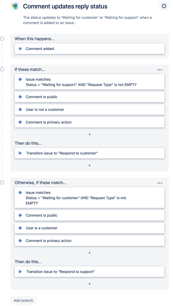

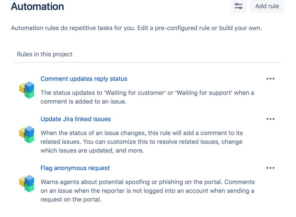

Good catch, but that's not the issue.  I should have pasted in screen shots, but can confirm that the status *does* change to *Waiting for Customer* when a comment is posted, but the SLA is not reset.
That said, here's the rules I already have--it's pretty close to the default set for Service Desk AFAIK:
Screen Shot 2019-04-30 at 9.04.29 AM.pngScreen Shot 2019-04-30 at 9.04.00 AM.png
Also, the SLA is properly reset when it was not in breach--I noted that originally, I think, but maybe it wasn't explicit enough. The only time I don't get the SLA reset is when we're in breach.  (But then it does reset when the customer subsequently comments...)

Based on the information you returned, I understood why you are reproducing the mentioned behavior, however, It's still not clear for me what is the behavior you are expecting.
The SLA is been reset when the customer answer because the issue is been transitioned to waiting for support, which is the condition that starts the SLA rule.
If you don't want the SLA to be reset when the issue is transitioned back to waiting for Support, you can use the Pause column instead of the stop column.
Could you please provide us the exact scenario that you expect using the SLAs? I think this will give us a better idea of how we can achieve your goal. :)
