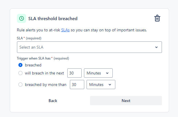

You have 3 triggers on SLA regarding Due Date
And assign custom calendar up to your preferences.

Confusing.
Will we able to set the Automation based on that.
Since the date is fixed in that specific field, the system should calculate the days and initiate the SLA for the request 10 days prior.
How can we able to set things up based on that ? @Jakub Koc
